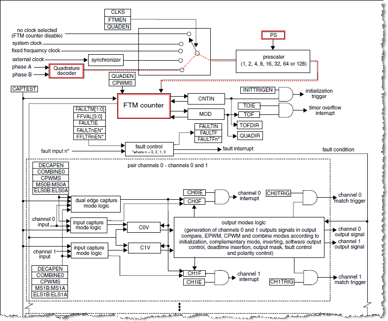

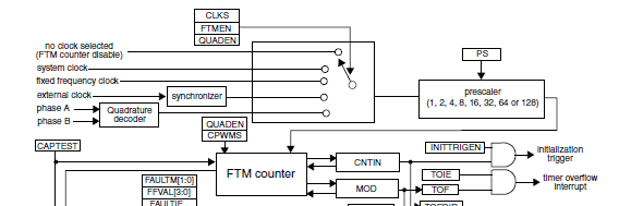

egoodii
Senior Contributor III
According to figure 44-3 of the reference manual KV5XP144M240RM.pdf, QD input DOES go thru the prescaler:
So you are seeing perfectly proper operation.

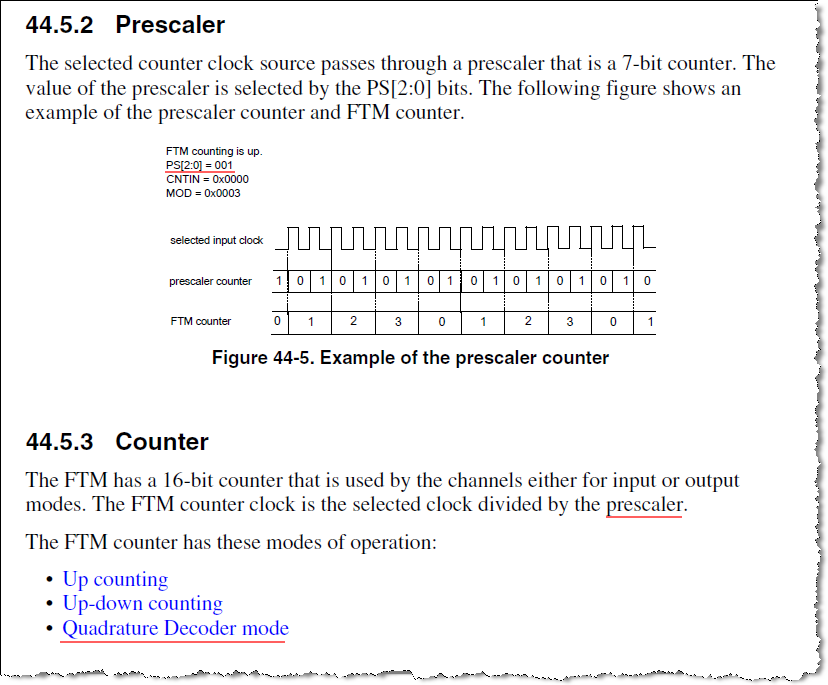

Robin_Shen
Please refer the 'Figure 44-3. FTM block diagram' in KV5XP144M240RM.
The FTM counter clock is the selected clock divided by the prescaler.
Robin

egoodii
I don't know what you mean by 'on purpose' in this context.  The hardware 'does what it does'; I see what you mean about Fig.44-91, it is 'a pity' the documentation writer elected to 'lump' prescaler functions within the 'FTM counter' functional block, but your own experiments confirm 'it is in the path'.  The fact a completely different family of parts works differently is not surprising.
I agree it seems a 'poor default' for a prescaler of 32, MOST applications of quadrature input need every edge they can see.  I can't comment on the 'filter value', as I don't know how the 'supplied value' is adapted into a 'register value' --- you can certainly look in your debugger and 'see what you get' from 16 (or try to follow the driver code!).
