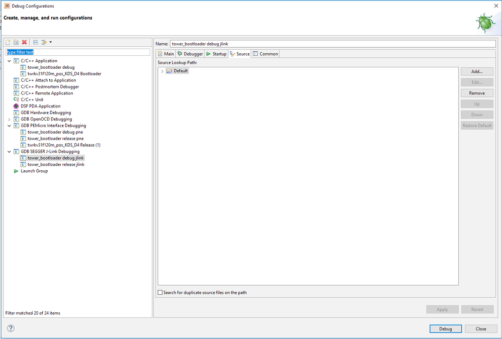

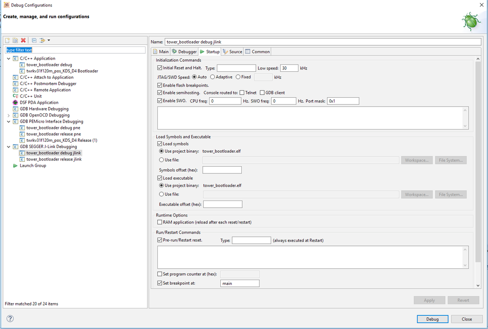

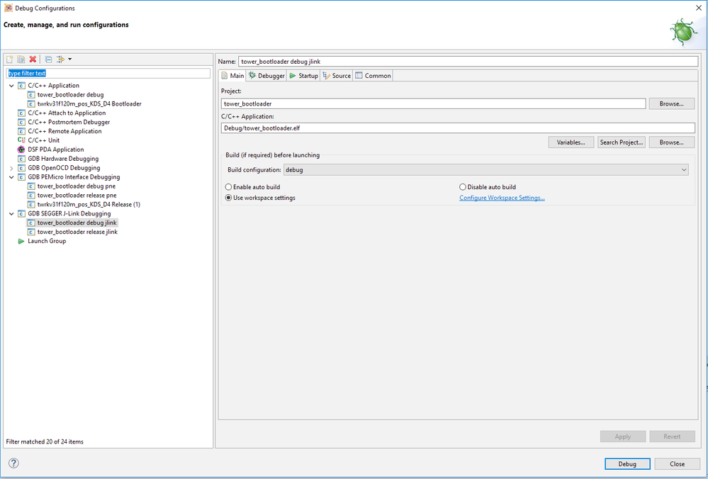

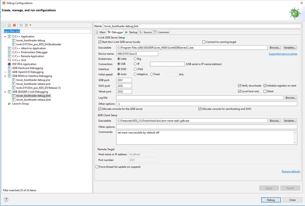

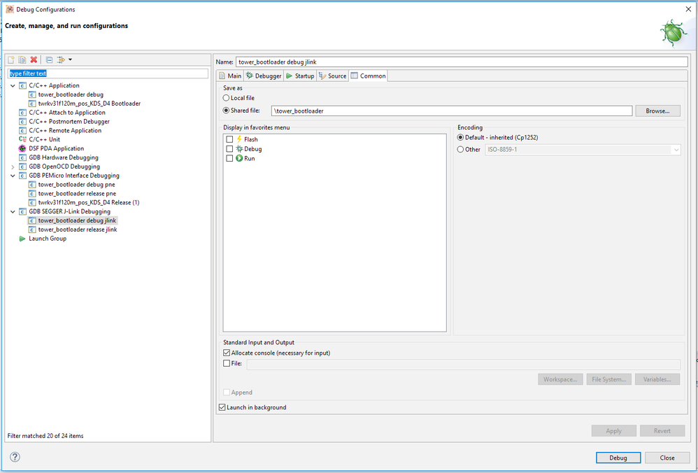

The debug configuration I am using is:
Screen Shot 2016-09-07 at 3.44.06 PM.pngScreen Shot 2016-09-07 at 3.44.21 PM.pngScreen Shot 2016-09-07 at 3.44.52 PM.pngScreen Shot 2016-09-07 at 3.45.07 PM.pngScreen Shot 2016-09-07 at 3.45.27 PM.png
I hope someone can help me.
Best Regrads,
Andoni

Hi Alice,
I tired changing the executable file and had the same error. I am using KDS 3.1.0 and a j-link segger debugger. I have also downloaded the latest drivers of the j-link from the segger page.
Andoni Ibarreche

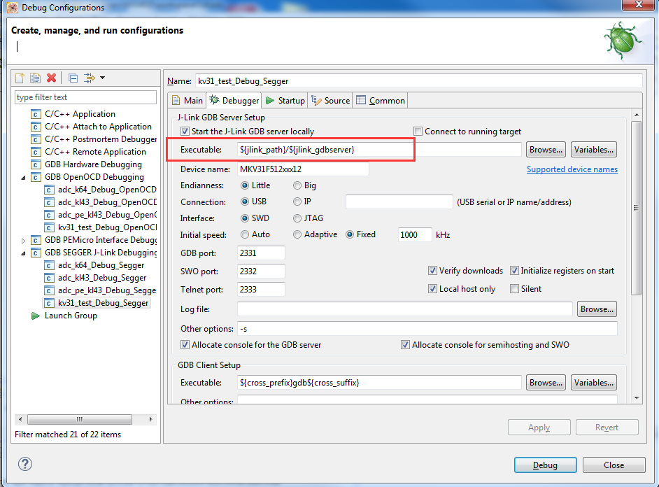

Hello Andoni,
- Please change the Excutable file path to have a try :
${jlink_path}/${jlink_gdbserver}
If still can not work, please tell me which version of KDS do you used ?
And how about download one simple project ?
You use the j-link segger debugger or the OpenSDA for JLINK ?
Hope it helps
Alice
