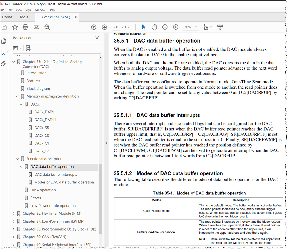

Please read the relevant chapter of the Kinetis KV11: 75 MHz Arm Cortex-M0+ 64/128 KB Flash (32-64 pin)
There is description about DAC_SetBufferValue.

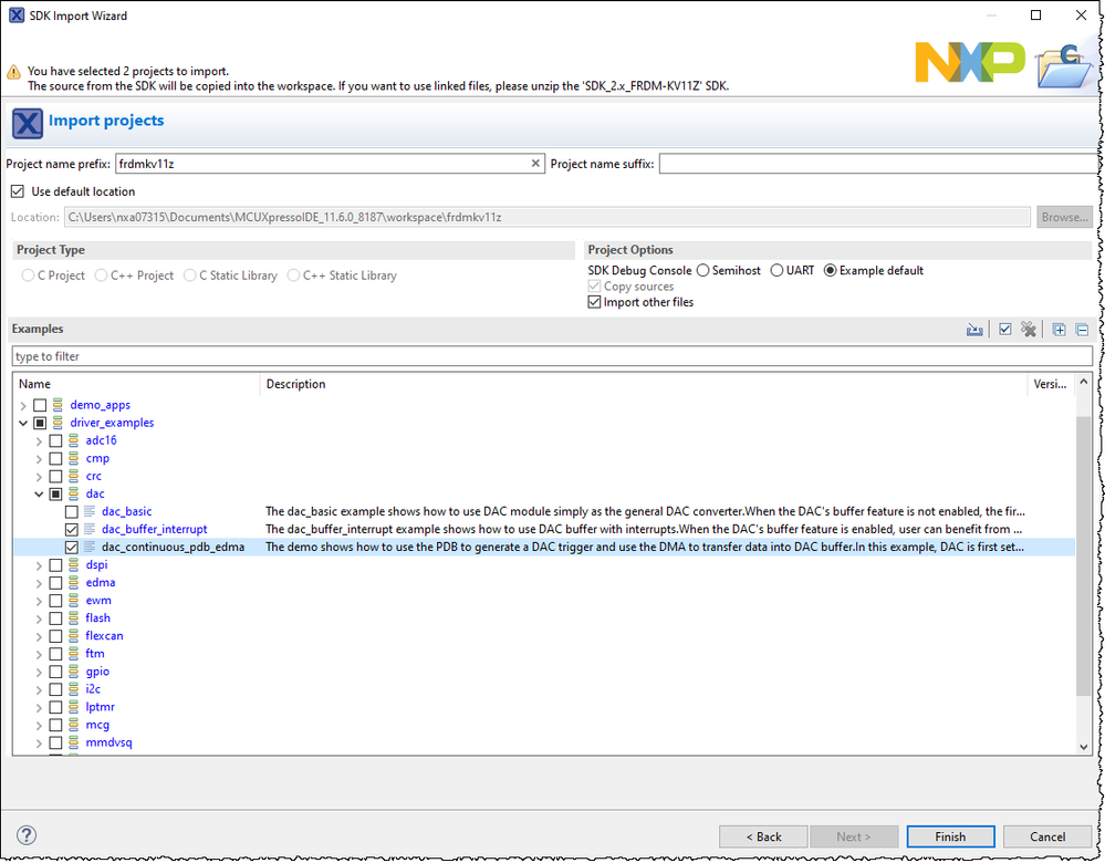

Please refer to the other two examples in the SDK:

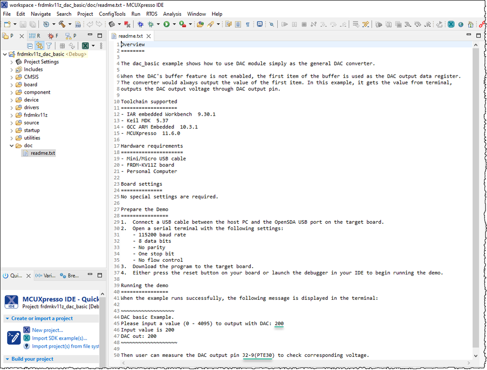

Did you follow the readme.txt of dac_basic example? Please input the value from terminal.

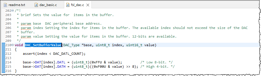

Thanks for your answer. Can you also inform me about the buffer ? I do not understand about why we use buffer and what is the function of the buffer ? Also, I do not understant what is the function of the following code ?
void DAC_SetBufferValue(DAC_Type *base, uint8_t index, uint16_t value)
assert(index < DAC_DATL_COUNT);
base->DAT[index].DATL = (uint8_t)(0xFFU & value); /* Low 8-bit. */
base->DAT[index].DATH = (uint8_t)((0xF00U & value) >> 8); /* High 4-bit. */
