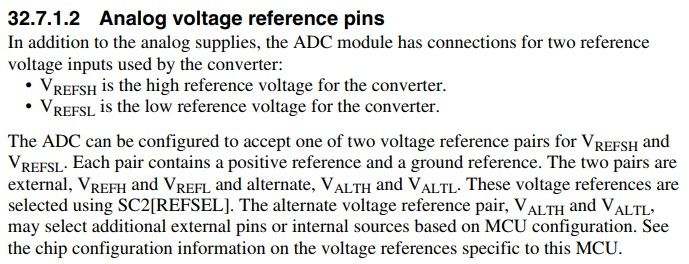

With the ADC of the KM34 you cannot sense current directly.
What is the internal reference voltage being used for the comparator?
I recommend you to check the chapter 32 of the Reference manual. In this chapter you will find the following information regarding the reference voltage used by the ADC.

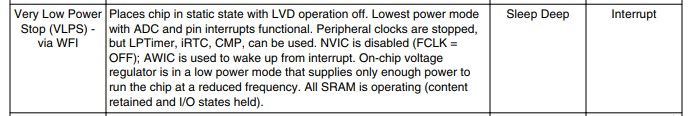

Can this sensing be done during lowest sleep state (in terms of power consumption)
In the reference manual chapter 7, table 7.1 you can find the following information regarding this question.
