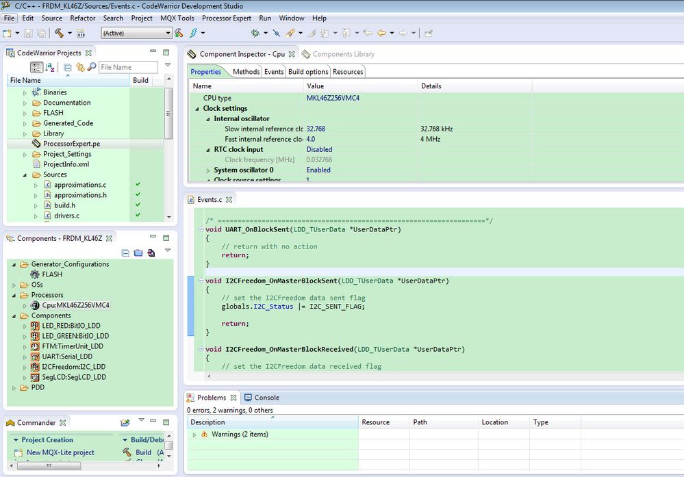

kerryzhou
Hi Bertan,
    Please see this picture:
    That's the accelerator code.
    About whether you need to change the PINS and address, it determined by your hardware, you should choose the according pin which your sensor are using, the address you should read your sensor's datasheet.
  I don't have the 9-axis code directly, you need to write the code by yourself and refer to the accelerator code.
