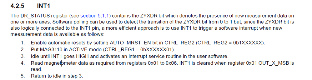

I have a problem with configuring MAG3110  interrupts. The PTD1 pin is always HIGH.

Hi Rafal Jablonski,
   About the MAG3110 interrupt usage, you need to follow these step:
   Please check it on your side, do you finish these step?
If you still have question after the test, please tell me the updated information.

Hi Kerry Zhou,
I was finished this steps before I wrote that post, but it doesn't work. Pin INT is always HIGH, even when I read 0x01 OUT_X_MSB register.
