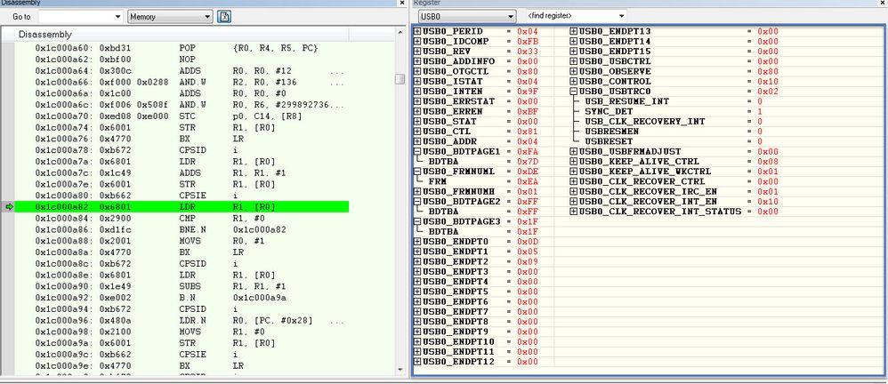

rafaeltoledo
Hi jeremyzhou,
Thanks alot for the help.
Really the problem is the ''dirt'' that comes from initialized USB on bootloader.
How I resolve this?
I'm trying to force the USB0 registers to default value at the beginning of my code, but the same problem occours when I try write a value to any usb register.
Any suggestion?

jeremyzhou
Hi Rafael,
Thanks for your reply.
After verified it, the MCU doesn't jump out the debug mode after inject the reset command.
So I'd highly recommend you to figure out which the code line the MCU stuck in by using the usage of step into function.
It's easy to illustrate the root cause of issue by implement the approach.
Ping

rafaeltoledo
Hi jeremyzhou,
thanks for the help.
I'm testing what's causing the program halt after command reset, and I found this thread on forum:
KL27Z Bootloader ROM problems
The reply from Mark Butcher helped me alot.
Now i'm testing component by component instantiated on my code, and for my surprise, when I disabled all code related about my USB HID, the reset command works fine.
I'm reading capter 13(Kinetis ROM bootloader) from KL27Z reference manual, to understand the bootloader better
You have any suggestion for study the problem resolution?
