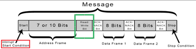

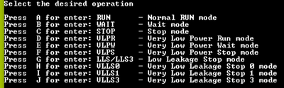

How are you doing the measure? I made some probes with option B from the example.
Then I add the I2C with the interrupt and has a good result.

        PRINTF("Select the wake up source:\r\n");
        PRINTF("Press T for LPTMR - Low Power Timer\r\n");
        PRINTF("Press S for switch/button %s. \r\n", APP_WAKEUP_BUTTON_NAME);
        PRINTF("\r\nWaiting for key press..\r\n\r\n");
        ch = GETCHAR();

Pavel
27,183 Views
Ravikumar1
Hi @Pavel_Hernandez
First of all thanks for the reply,
Actually I used power_manager demo code from SDK-FRDM-KL27Z and I tested with all the power mode options present in the code. by using UART to send the character like below shows A,B,C etc..
Press A for enter: RUN - Normal RUN mode
Press B for enter: Wait - Wait mode
Press C for enter: Stop - Stop mode
Press D for enter: VLPR - Very Low Power Run mode
Press E for enter: VLPW - Very Low Power Wait mode
Press F for enter: VLPS - Very Low Power Stop mode
Press G for enter: LLS - Low Leakage Stop mode
Press H for enter: VLLS0 - Very Low Leakage Stop 0 mode
Press I for enter: VLLS1 - Very Low Leakage Stop 1 mode
Press J for enter: VLLS3 - Very Low Leakage Stop 3 mode
I connected FRDM-KL27Z board with UART pins (J1-2 for UART0-Rx, J1-4 for UART0-Tx)  and Power supply pins (J3-8 for 3.3V ang J3-12 for GND). In between power supply I connected ammeter/ multimeter with series. I got current drawn results like shown below,
RUN - Normal RUN mode ------>  16.98 mA
Wait - Wait mode ----->  12.81 mA
Stop - Stop mode ----->  9.99 mA
VLPR - Very Low Power Run mode  ------->  10.65 mA
VLPW - Very Low Power Wait mode  ------>  9.90 mA
VLPS - Very Low Power Stop mode  ------->  9.88 mA
LLS - Low Leakage Stop mode  ------------->  9.89mA
VLLS0 - Very Low Leakage Stop 0 mode ---->Not support LPTMR Wakeup
VLLS1 - Very Low Leakage Stop 1 mode ---->9.88 mA
VLLS3 - Very Low Leakage Stop 3 mode ---->9.80 mA
Actually expected results in micro amps but we got in milli amps, could you please tell me the reason and help me to resolve this issue.
And you mentioned that you got good result, how much current drawn did you get.
Ravikumar.

Thanks for being clear, I think you are misunderstanding the power saver mode, this mode only affects the MCU part, I only do not understand how you are measuring the amp with the pins [J3-8 for 3.3V and J3-12 for GND], the best way to get the data corresponding to the Datasheet.
In the schematic of the KL27 you can use the J17, but you need to remove the resistor R2 and R1.
But maybe other components are connected to the same rail and the Amp values could be near to the datasheet. If you need more information please let me know.
Pavel

Here the micro will wakeup both write and read interrupt is occurred. But I want to wake up only when write event / interrupt.
But here I found both cases (write and read) the status register set write bit only, not set for read bit will you please tell me the reason for this and give me some solution.
Ravikumar.
27,049 Views
Pavel_Hernandez
I think this is not possible because the I2C NVIC will detect the start, I suggest in your code send the device to low power if the R/W bit is R, I do not know how is your final application.
Unfortunately, that interrupt flag is not available, I apologize if this information is not helpful.

Actually after entering the sleep I send read/ write through I2C. But I got only "status 0", means I can wakeup when I2Cslave address matched but read/ write status is always come with write (0) only even if I send read event also.
So is there any pre configuration do I need to set before entering sleep mode for getting read/ write status.
Thanks and Regards,
Ravikumar.
27,027 Views
Pavel_Hernandez
I review the information in the reference manual, unfortunately, the matching address is the only wakeup method, I was wrong.
Pavel
