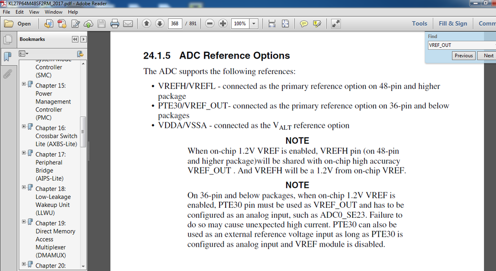

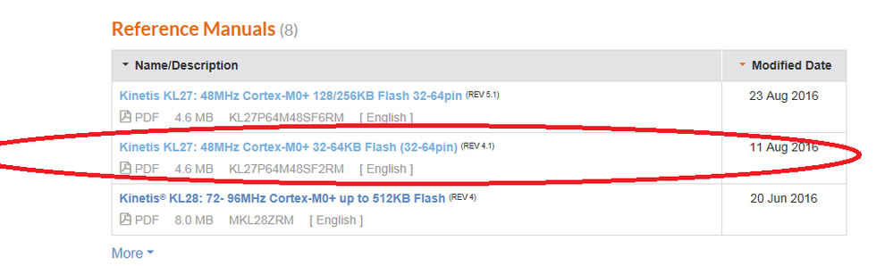

After communicating with Hy Mai, i see that customer uses MKL27Z64VFM4 with 32 pin LQFP package,and the ADC sample will saturate to 0xFFFF in 16 bits mode when the analog voltage exceeds 2.5V. In other words, the question now is what is the ADC voltage reference?
First of all, we should download the KL27P64M48SF2RM from the link for MKL27Z64VFM4 with 32 pin LQFP package:
ARM Cortex-M0+|Ultra-Low Power Kinetis KL2x USB MCU|NXP
Based on the RM, this is the section to discuss the reference voltage of ADC:
Because I have not the board with MKL27Z64VFM4, pls have try for the follwoing setting:
1)connect a 0.1uF capacitor on the PTE30 pin, have a test without modifying any code.
2)change the VREFH setting with ADCx_SC2[REFSEL]=2b'01 and have the ADC sample.
