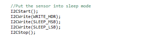

I'm able to write the slave address and get a response from the device, but get stuck waiting for a response after the second write. Upon further examination, I find that the second write does not change the value in I2C0->D from the value I had previously loaded into it. Any thought?
Attached: a snipped of my START signal and I2C write command

Hi Kerry, here is the code snipped in question. The problem arises after the first I2CWrite call near the end of SensorInit. It sends the address and the write bit successfully (0xE0, the device is the SHTC3 dual sensor), but then hangs in the second call to I2CWrite when it tries to send the SLEEP_MSB. In the debugger, I have noted that after writing the SLEEP_MSB to I2C->D, the value does not change, and remains as 0xE0. Hence, it seems to me that my KL26 I2C module is not sending the second byte. Unfortunately I do not have access to a scope at the moment so I can not confirm this.

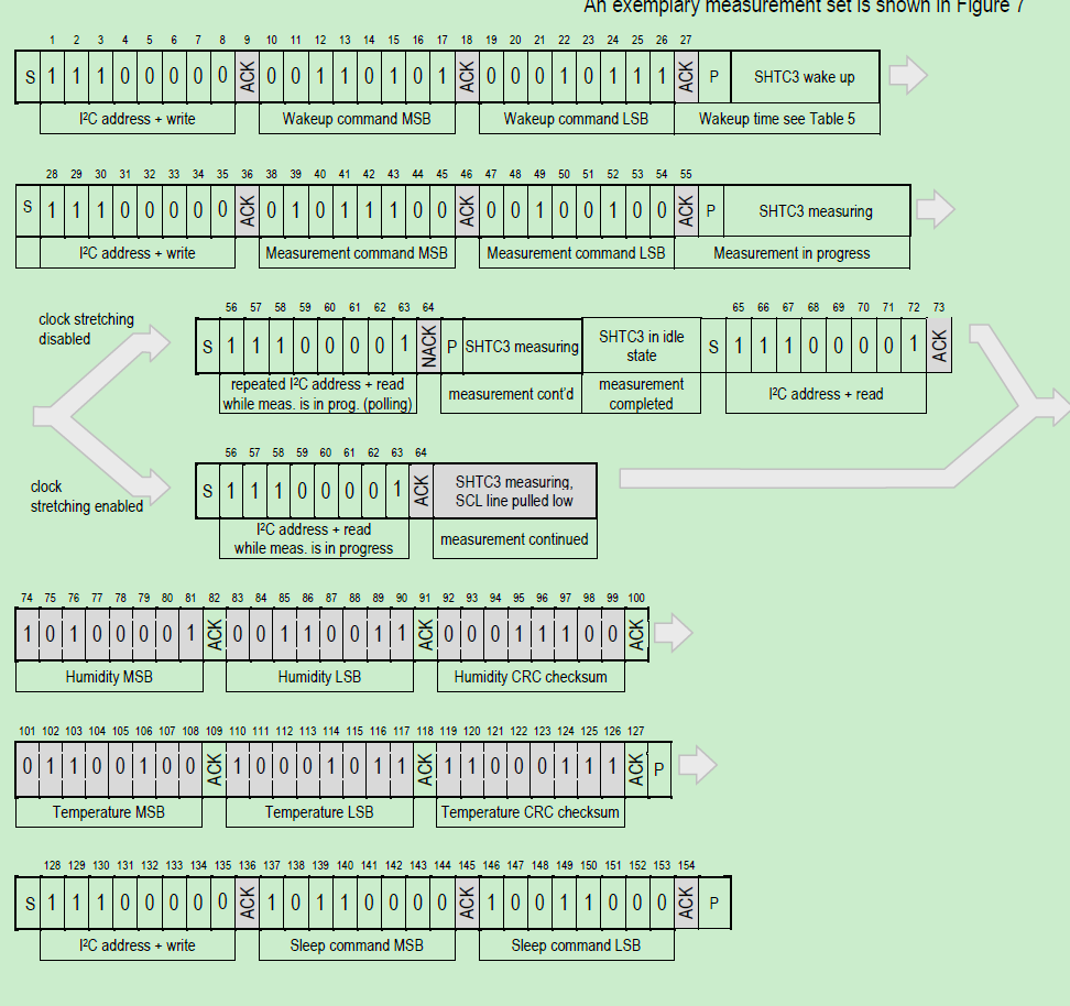

  You didn't wait the ACK.
   From your slave, you can know the I2C wave should be:
 But, you check your own code, you just write the buffer and clear the flag, then no wait for the ACK.

       Or you need to check with your I2C slave, the second write wave requirement.
