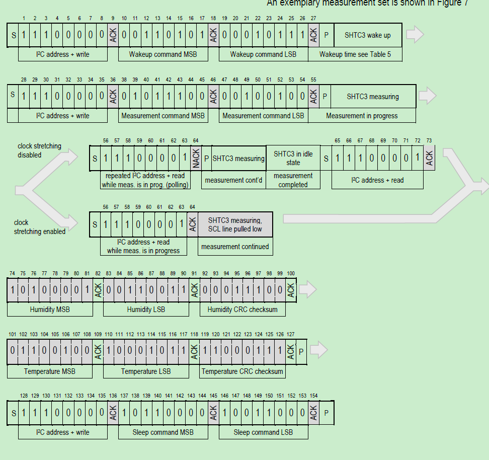

I'm able to write the slave address and get a response from the device, but get stuck waiting for a response after the second write. Upon further examination, I find that the second write does not change the value in I2C0->D from the value I had previously loaded into it. Any thought?

cameronehlers2
Hi Kerry, here is the code snipped in question. The problem arises after the first I2CWrite call near the end of SensorInit. It sends the address and the write bit successfully (0xE0, the device is the SHTC3 dual sensor), but then hangs in the second call to I2CWrite when it tries to send the SLEEP_MSB. In the debugger, I have noted that after writing the SLEEP_MSB to I2C->D, the value does not change, and remains as 0xE0. Hence, it seems to me that my KL26 I2C module is not sending the second byte. Unfortunately I do not have access to a scope at the moment so I can not confirm this.
Link to SHTC3 datasheet: https://media.digikey.com/pdf/Data%20Sheets/Sensirion%20PDFs/HT_DS_SHTC3_D1.pdf

I implemented your suggestions. I am now suspecting a hardware issue with my slave device. I find that as soon as I write the address + write big into I2C0->D, the MST bit in I2C0->C1 goes low, which according to the datasheet issues a STOP bit. Could losing master mode after writing be the result of a hardware issue or is something else at play?

cameronehlers2
My external pullups are both about 1k.
Upon checking the status register, you are correct about loss of arbitration, the instant after I send the address plus write bit to the data register, the ARBL bit is set, and the I2C goes into slave mode, hence the inability to continue transmiting.
Do you know of any common mistakes that can cause loss of arbitration?

kerryzhou
Hello Cameron Ehlers
  You didn't wait the ACK.
   From your slave, you can know the I2C wave should be:
 But, you check your own code, you just write the buffer and clear the flag, then no wait for the ACK.
I share some code which I wrote for the other slave, just for your reference:
