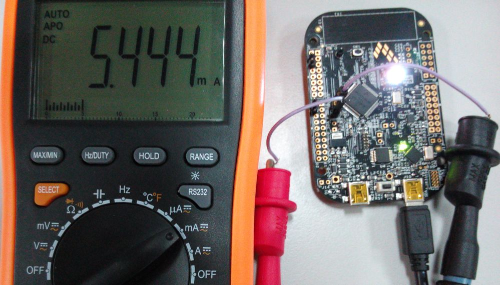

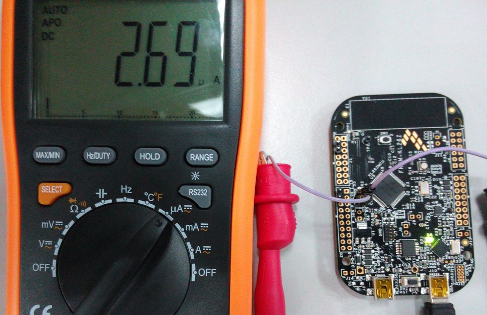

jeremyzhou
Hi Joaquim,
I've tested the low power demo which doesn't integrate the PE and you also can find this demo throught this path <dir_stall>\FRDM-KL26Z_SC_Rev_1.0\klxx-sc-baremetal\build\iar\low_power_demo.
These figures below show the test resut. and the current consumption conforms to the data sheet specification.
So I'd like to suggest that you can test this demo by yourself.
Hope this reply hope.
Ping
1. In RUN mode
2. In VLPS mode
6,925 Views

joaquimmartinez
Hi Ping,
Finally I can to enter into VLPS mode and now my current consumption is 2.8uA!!! Thank you very much for your help in this issue.

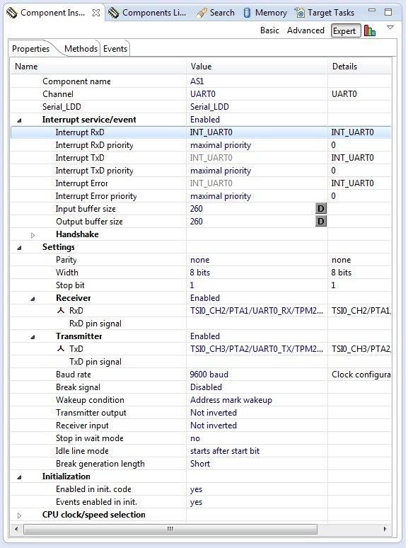

Now I'm trying to use the UART0 in VLPS mode. Basically my app is sleeping and I when a RX frame from UART0, the KL26 wakeup. I'm trying to configure this, but the KL26 doesn't wakeup, even if in the RX pin is active (the slave sends frames to the KL26).
I've found a documentation "KLQRUG.pdf" with an example (example 2: functionality of UART0 in VLPS mode), and I've written the code in my app (with a little modifications to adapt it to my hard and config), but the KL26 is always sleeping.
Please, can you help me in this new issue?
I explain you my configuration:
1. I'm using the same clock configuration of the PEx_lowpower_example.
2. I'm using the PE for the UART0 (AS1). Is a CPU Internal Peripherals. Please, see the image below:
2. After the function PE_low_level_init();, I've tried 3 different UART0 configurations to wakeup the KL26, but the results are the same, no wakeup:
2.1. Using only the PE with setting "Wakeup condition == Idle line wakeup"
2.2. Using only the PE with setting "Wakeup condition == Address mark wakeup"
2.3. Using only the PE with setting "Wakeup condition == Address mark wakeup" and reconfiguring the UART0 with the code:
NOTE: my freceived frame would be:
FF 02 0C 22 13 63 4B 30 52 39 01 21 93 4C 03

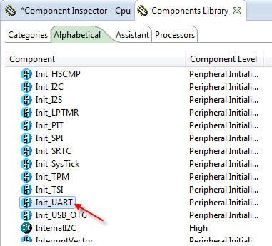

jeremyzhou
Hi Joaquim,
I'd like to suggest that you'd better use choose the component to implement in the project (Fig 1). Because this component support more paramenters to set, then it's easily for you to migrate the functionality of UART0 in VLPS mode in KLRUG.pdf to your project.
                                                      Fig 1
Ping
6,925 Views

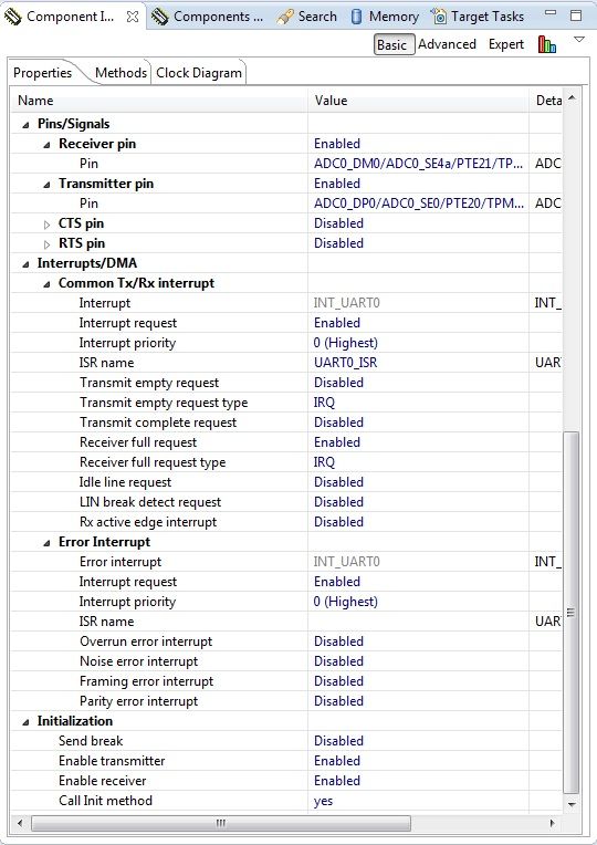

joaquimmartinez
Hi Ping,
I used this new component and I used it. The problem is that the Init_UART doesn't have neither methods nor events to use (for example to send a block or receive blocks). This is because I'm using the AS1:AsynchroSerial component.
In addition, is not possible to share the UART0 with both components.
If I use the Init_UART component, what functions to send and receive must I to use?
Thanks.

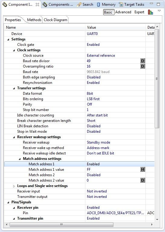

joaquimmartinez
Hi Ping,
I've just configured the UART with Init_UART Component.
I've created a simple code to receive frames. It works fine in RUN mode, but in VLPS I have the same problem, the KL26 is always sleeping. I've used wakeup idle and mask.
I'm thinking that in VLPS is not possible to wakeup the KL26...
I sent you my code:
* AS1_Received INT
