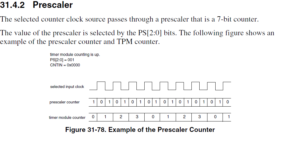

I read and test the TPM in the FRDM-KL26Z ev board.
And I have a question about Prescaler in the chip datasheet(KL26 Sub-Family Reference Manual, Rev. 3.2, October 2013)
Is it correct? PS[2:0] = 001, the input clock freq shall be divided by 2 to the TPM.
The diagram looks the timer module counter increases as same as the input clock.
Henry

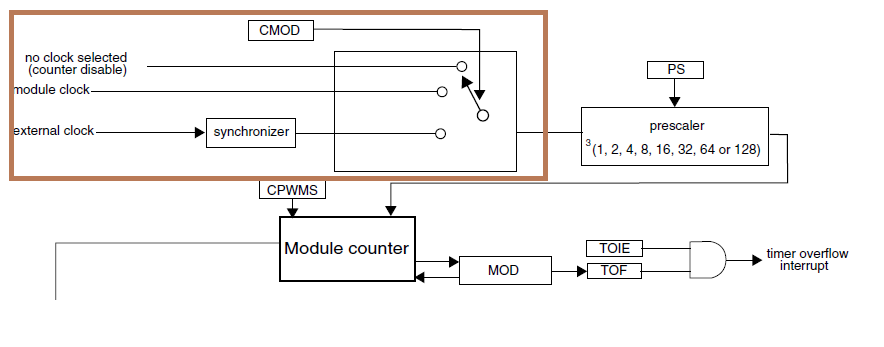

Hi Henry ,
I think you can understand like this , consider the hole block as the counter clock:
In fact , the prescaler is just a factor.
Hope it helps
Alice
2,338 Views
Hi Henry,
Yes, this is right.
Pay attention to that the "slected input clock" is after devided   frequency clock.

henryxin
Hi Alice,
Does it mean that the selected counter clock source, which passes through a prescaler, becomes the selected counter clock?
I will consider the red block as selected counter clock. It is a little confusing.
Henry

henryxin
Hi Alice,
Thanks. It is helpful to understand.
