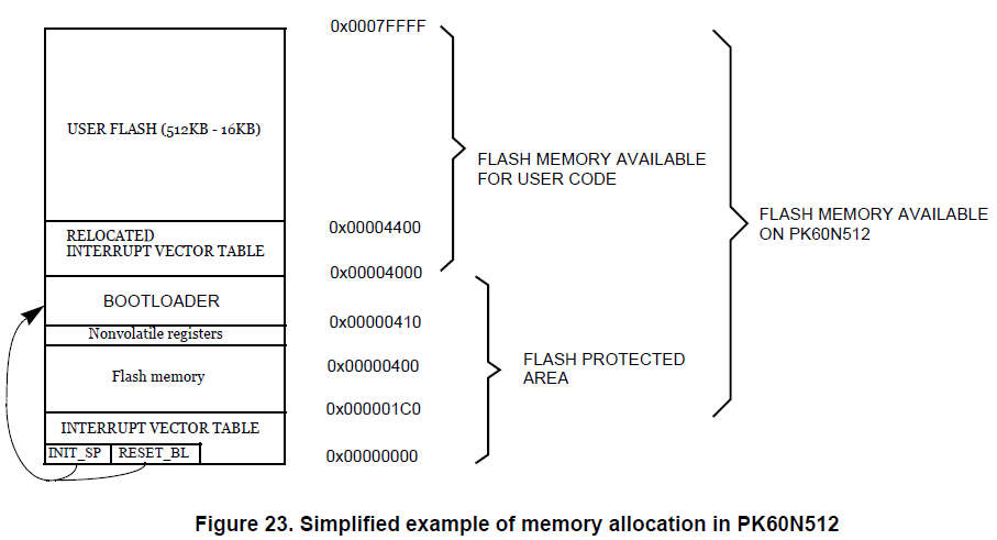

I've got a KL26 and I'm trying to get my bootloader to jump to the application. Can you show me the procedures in C and how to verify they are working correctly?

I am the author of bootloader AN2295 for Kinetis.  When you jump to the application from the bootloader you need to be sure that SP - stack pointer is initialized after that the procedure is only to put the startup address of your application to the PC (program counter). You can put short assembler code into the C function as was mentioned.

Hi Michael
If you want to jump to your application, you should be sure of the memory allocation, the memory address of your app and the interrupt vector table.
The next image show an example of memory map
For more information about the memory distribution and the protocol see the next application note
http://cache.nxp.com/files/microcontrollers/doc/app_note/AN2295.pdf
To be sure in which mode the uC is, you should ask of the status and decide if you want to jump to the application.

After that you will jump to the application sending parameters the stack pointer and the program counter and do some assembly instructions
    // Jump to user application
    JumpToUserApplication(*((unsigned long*)RELOCATED_VECTORS), *((unsigned long*)(RELOCATED_VECTORS+4)));

You already have the image address for the stack pointer and the program counter, you verify that the address are correct and if exist a code for application and then you load to the SP and PC in an assembly way.
