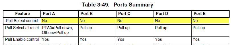

I try in KL25Z to clear bit PS (for pull-down) in any register PORx_PCRn Without success.
For example, I write the next simple command
PORTE_PCR2 &= ~PORT_PCR_PS_MASK;
There is no effect.
Why? How to resolve this?
Hanan
1,187 Views
Jorge_Gonzalez
Hello Hanan Ribo:
KL25 has pull-enable control, but only to enable pull-ups. Pull select is not available at any port. See the next table from KL25 Reference Manual
