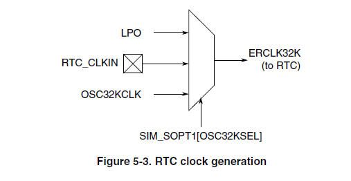

I'm trying to run the RTC of a KL25 using the internal oscillato but it does not work. If I use an external CLK works. I am using an 8MHz quartz. can anyone help me?

When the RTC clock is LPO (1KHz), the second register will increase 1 every 32.768 seconds.

if I set SIM_SOPT1 |= SIM_SOPT1_OSC32KSEL(0); the RTC don't work!
why?
Thank you for attention.
7,109 Views
Hui_Ma
When you select to use SIM_SOPT1_OSC32KSEL(0) setting, first of all it need external 32KHz crystal or oscillator connect with system oscillator. Then the KL25 MCG work mode should be in FEI or FEE mode (external 32KHz clock can't be PLL reference clock, so PLL can't be enabled).
You can use below code to enable OSC32KCLK as RTC clock:
    SIM_SOPT1 |= SIM_SOPT1_OSC32KSEL(0);  //select system osciallto as RTC clock source
    OSC0_CR |= OSC_CR_ERCLKEN_MASK;  //external reference clock is enabled
    RTC_CR |= (RTC_CR_OSCE_MASK);   //32.768KHz oscillator is enabled
Wish it helps.

What you are trying to do is impossible.  If you want to use the system oscillator to clock the RTC (SIM_SOPT1[OSC32KSEL] = 0), then the system oscillator must be configured to use a 32 KHz source.  There is no way to use an 8 MHz crystal and clock the RTC from OSC32KCLK.
Also, to answer your claim that RTC_CR |= (RTC_CR_OSCE_MASK); crashes the program.  I assume you are using an 8 MHz oscillator to clock the system clock.  In which case, I would expect this to crash the program.  From the KL25 reference manual:
RTC_CR[OSCE] can override the configuration of the System OSC, configuring the
OSC for 32kHz crystal operation in all power modes (except VLLS0) and through any
System Reset. When OSCE is enabled, the RTC also overrides the capacitor
configurations.
So when you set OSCE bit, you ARE re-configuring the System OSC for 32KHz crystal operation. We apologize for any inconvenience this may have caused.

The KL25 RTC module could use three clock source: LPO, RTC_CLKIN pin input clock and OSC32KCLK (system oscillator 32KHz output). You could get more detailed at RM chapter 5.7.3 RTC clocking. RTC can't use on-chip 32KHz IRC as clock source.
Wish it helps.
