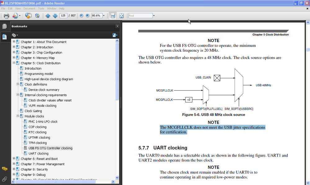

Kan_Li
Hi Christopher,
As RM states as below:
so we don't recommend using internal clock in USB application.
You might have to use an external ref instead.
Sorry for the inconvenience that has caused...
Please kindly let me know if you have any issue.

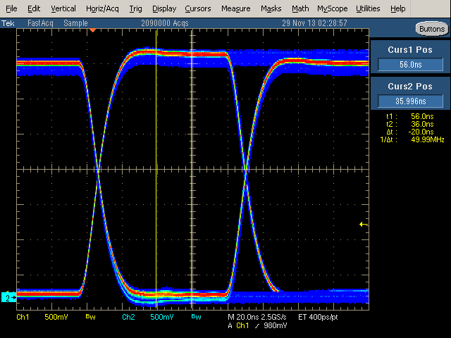

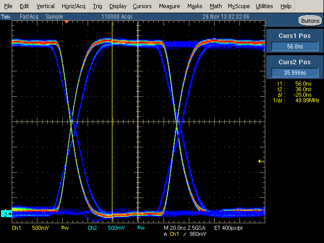

I captured the following two "eye" diagrams from the K20 in the McHck board:
And then the KL24 in my custom board:
I captured these on a TDS5054B in "FastAcq" mode.
I just want to confirm my belief that these additional lines in the KL24 trace are evidence towards the internal oscillator being not sufficiently accurate for USB and that I should proceed with adding a crystal.  I just want to make sure that there wasn't some other possibility given these traces.
