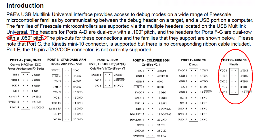

Whats connections need to be done to program KL2 using universal multilink??

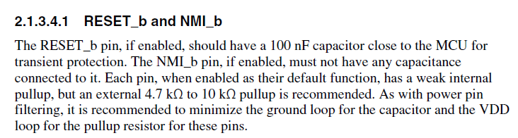

Also what vaule of resistor and capacitor need to put on the Reset pin??
What is the pitch of the programming pins used in the connector for programming kinetisL devices??

Hi, Nisha
For resistor and capacitor value of reset pin and debug interface, I think you can reference our freedom board design schematic. Please reference attached.

Kan_Li
Hi Nishasingh,
KL2 supports SWD interface, and if you use universal multilink, please use the mini 10 port referring to the following snapshot, and size spec is also included.
The recommended resistor and capacitor need to put on the Reset pin can be found in http://cache.freescale.com/files/32bit/doc/quick_ref_guide/KLQRUG.pdf?fpsp=1, you may also refer to the following for details.
