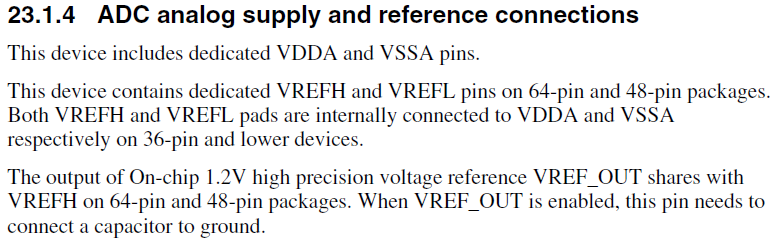

For different packages, the ADC reference may different. Which package are you using?
And if you have set the VREFEN bit in VREF_SC?

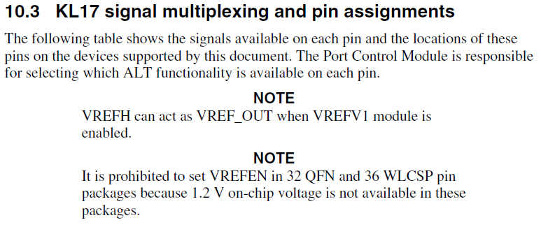

gn2303
I have found the problem. In my case it is because I used a lower pin count model of the KL17z. Models with 36 pins or less, does not have VREFL and VREFH as voltage reference. Hence, the voltage reference must be changed by changing the REFSEL in the SC2 register. These are actually stated in the reference manual.

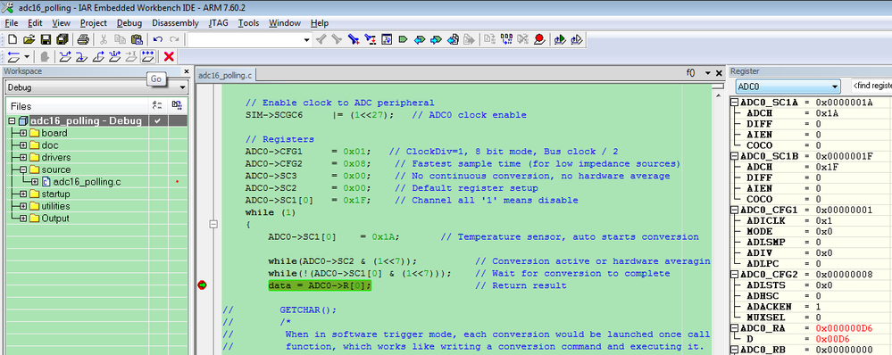

Hi John,
If you slow down the ADC clock(ADC0->CFG1= 0x61) and then set a breakpoint at line (data = ADC0->R[0];), will the ADC0_RA result always equal to 0xff?
I only have FRDM-KL27Z , and the result changes each time Go to this line.
I have also ask our internal team who can test the code on KL17, will give you the feedback when I get it.
