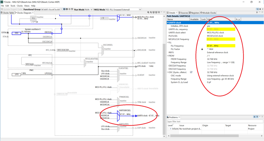

shrejjjhh
Hi jing,
I am using the same tool MCUXpresso Config Tools for clock configuration. The default clock configuration for MKL15Z128CAD4R shows UART0 clock is inactive as shown in the diagram.ClockConfig.png

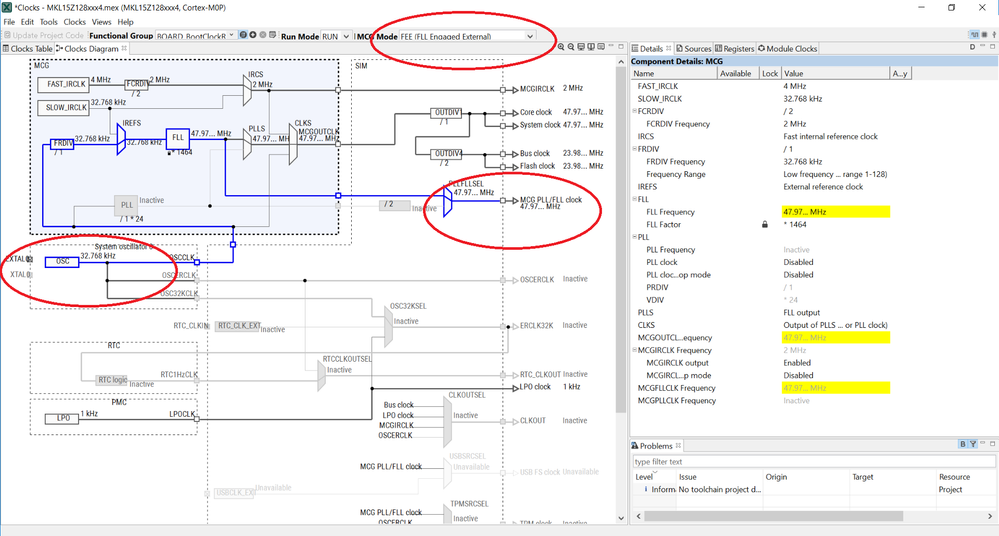

jingpan
Please set as my picture. Remember you can click every thing on the diagram that you want to change.

shrejjjhh
Hi Jing,
Thanks for your replay. The above settings worked for me but in FEI mode.
