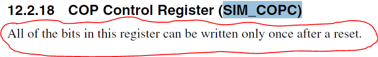

Dear Freescale Community,
I am currently developing on KL15 microcontroller, Bareboard without PE. As required, I would like to enable watchdog timer for security reasons. Right now I am running a small testing program with watchdog timer enabled at the starting of the main and do not feed anything to it. I expect that the program resets itself frequently. However, the program runs per normal. It looks like the watchdog is never enabled. I am attaching my code for reference. Hope I can get some help in clearing my doubts.
Thank you.

The SIM_COPC register can only be written once after a reset. This means that, since you are immediately disabling it, you can not enable it again later.

Hi Mark,
To my understanding, watchdog time should be able to be enabled in run time.
Regarding
Can you provide some reference for the above information? I cannot find it stated anywhere.
Thank you.

mjbcswitzerland
Specialist V
Xavier
First line in the KL15P80M48SF0RM.pdf User's Manual describing the register:

xaviermao
Hi Mark,
You are right, I miss understood the statement. I thought it can be written multiple times, but immediately after a reset. Previously I tested without disabling watchdog timer in my program but it was not working. It turned out that SIM_COPC was assigned to 0x00 in the device bootloader. As a result, it was always disabled no matter what I do in my program.
Thank you so much for pointing out it !
