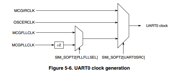

I am trying to route the output of the PLL to clock the UART0. In the ref manual, chapter 5 page 117, clocking options for UART0 are shown as below:

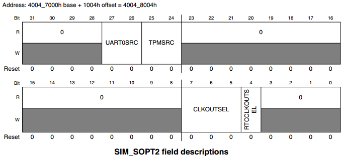

But I could not find PLLFLLSEL bits in the SIM_SOPT2. The description of SIM_SOPT2 is shown as below (Section 12.2.3 page 186):
Anyone know are these bits implemented for KL15 chips?

Paul_Tian
Hi, Safwat
This is a document issue. The bit 16 in register SIM_SOPT2 is PLLFLLSEL.

markosiponen
The SIM_SOPT2_PLLFLLSEL bit is also missing in Processor Expert generated file (IO_Map.h):
/* SOPT2 Bit Fields */
#define SIM_SOPT2_RTCCLKOUTSEL_MASK              0x10u
#define SIM_SOPT2_RTCCLKOUTSEL_SHIFT             4
#define SIM_SOPT2_CLKOUTSEL_MASK                 0xE0u
#define SIM_SOPT2_CLKOUTSEL_SHIFT                5
#define SIM_SOPT2_CLKOUTSEL(x)                   (((uint32_t)(((uint32_t)(x))<<SIM_SOPT2_CLKOUTSEL_SHIFT))&SIM_SOPT2_CLKOUTSEL_MASK)
#define SIM_SOPT2_TPMSRC_MASK                    0x3000000u
#define SIM_SOPT2_TPMSRC_SHIFT                   24
#define SIM_SOPT2_TPMSRC(x)                      (((uint32_t)(((uint32_t)(x))<<SIM_SOPT2_TPMSRC_SHIFT))&SIM_SOPT2_TPMSRC_MASK)
#define SIM_SOPT2_UART0SRC_MASK                  0xC000000u
#define SIM_SOPT2_UART0SRC_SHIFT                 26
#define SIM_SOPT2_UART0SRC(x)                    (((uint32_t)(((uint32_t)(x))<<SIM_SOPT2_UART0SRC_SHIFT))&SIM_SOPT2_UART0SRC_MASK)
