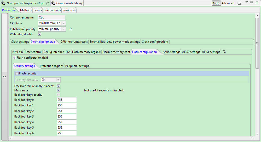

Could you provides KL15 Flash configuration field value?

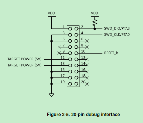

And if it is possible, could you provide the KL15 SWD interface related circuit also?

- Using JLINK Base, 1.8V logic, See Attached picture.
- nRst jump is populated, and no pullups or pulldowns are on.
- System worked flawlessly before we started working with the flash and killed it.

-I am sorry but I will need some guidance on how to find those things. We use PE (Driver Suite 10.4) to export into Keil, and then this project has it's specific settings.
- **See 2nd picture attached, is this what you wanted? If not please send more detail to I can get you what you need.

1. About SWD interface, your attached SWD debug interface is different with Freescale recommended at pin numbers order.
For you could program and debug the KL15 chip before, I think that's ok.
Below is Freescale recommended SWD debug interface:
2. For you are using the Processor Expert v10.4, I would you could provide the Flash configuration field value.
Please check below picture as a reference:
