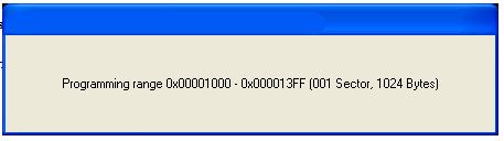

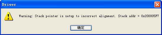

I was based KL05-SC.zip sample package development , here is my rewrite ICF file, the system reported an error stack pointer .

I use Freescale official routines (kl02sc.exe) 32KB _ Pflash.ICF file rewrite to 16K_Pflash.ICF file, the 16k_Pflash.ICF content is:

3,779 Views
jeremyzhou
Hi Thooman,
Thanks for your reply. I've corrected your ICF file and you could give a shot.

Ping

It has been tested, the error persists
3,779 Views
jeremyzhou
Hi Thooman,
Was that a same error like before?
I was wondering if you could proved the error screenshot?
Have a nice day!

I have also tried it, and found that there was no longer an error, of the reasons for that define the symbol __CFEDIT_region_RAM_Start__  = 0X0; I is defined as 0X1 FFFFE00, if you give me the file, and then define exported symbol __ VECTOR RAM =__ICFEDIT_region_RAM_start - 0x410, will certainly be wrong, and I am of the program is not implemented.

jeremyzhou
Hi Thooman,
I‘m afraid that  MCU couldn't  work normally after you corrected define symbol __ICFEDIT_region_RAM_start__ = 0x0;
I've corrected the ICF again which show as follow.  And you also need to make the instructions which are used for copy the vector table to RAM don't operate in common_startup(void) function.
Please give a shout and update me instantly when you get result.

define exported symbol __VECTOR_RAM        = __ICFEDIT_region_RAM_start__ ;
define exported symbol __BOOT_STACK_ADDRESS = __region_RAM2_end__ - 8;
define symbol __code_start__ = __ICFEDIT_region_ROM_start__ + 0x410;//********
define memory mem with size = 4G;
define region ROM_region  = mem:[from __ICFEDIT_region_ROM_start__  to __ICFEDIT_region_ROM_end__];// | mem:[from __region_FlexNVM_start__ to __region_FlexNVM_end__];//********
define region RAM_region  = mem:[from __ICFEDIT_region_RAM_start__  to __region_RAM2_end__];// | mem:[from __region_RAM2_start__ to __region_RAM2_end__];
define block CSTACK    with alignment = 8, size = __ICFEDIT_size_cstack__  { };
define block HEAP      with alignment = 8, size = __ICFEDIT_size_heap__    { };
initialize manually { readwrite };
initialize manually { section .data};
initialize manually { section .textrw };
do not initialize  { section .noinit };
define block CodeRelocate { section .textrw_init };
define block CodeRelocateRam { section .textrw };
place at address mem:__ICFEDIT_intvec_start__ { readonly section .intvec };
place at address mem:__code_start__ { readonly section .noinit };
place in ROM_region  { readonly, block CodeRelocate};
place in RAM_region  { readwrite, block CodeRelocateRam,
                        block CSTACK, block HEAP };
