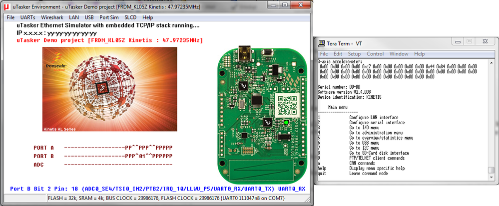

Code is available in the uTasker project: http://www.utasker.com/forum/index.php?topic=1721.0
which supports all KE, KL and K parts for interrupt driven and DMA modes [not KE since it doesn't support DMA] on all available UART interfaces - including the KL05Z.
The UART interface is described in http://www.utasker.com/docs/uTasker/uTaskerUART.PDF
You can also simulate the device and board which makes it easy to anayse the UART code (it simulates interrupts and DMA operation in approx. real-time) and maps the simulated UART to a real COM port as shown in the screen-shot below.
Mark
