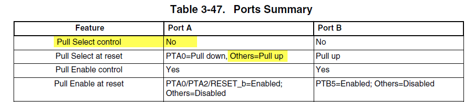

reading the KL05 reference manual i can't find any reason why  PTA13 could not have the pull down enabled.
Moving it by hand in debug mode it can't be set to 0.
Is there any errata about it or is it my fault??

Hello Diego:
This is not an errata. In your KL05 you can only enable Pull Up, but cannot select Pull Down. You can confirm this in the Chip Configuration -> Human Machine Interfaces chapter. See below:
I hope this clarifies.
