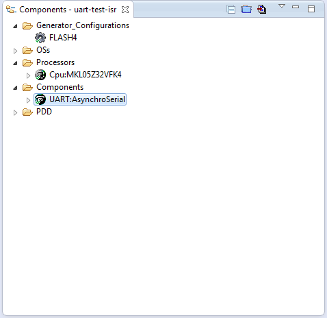

Using KDS 2.0.0 and Processor Expert plugin with its UART:AsynchroSerial component, I prepared two generally identical projects, the simplest as they can be, with only one difference. The first communicates with the device using no interrupts (TX_REQ to 0, some delay, and then reading the Rx register), the second uses interrupts. The first project is working fine - KL04 sets the pin to 0, the device starts sending data, the data appears in the register. The second one does not receive the data, although the data are present on the UART_RX pin (checked with the oscilloscope). The interrupt routine (automatically generated PE_ISR(ASerialLdd1_Interrupt)) is not called - at least the CPU does not stop there on a breakpoint in the debug mode. The Processor Expert settings say that the interrupts are enabled (Cpu:MKL04Z32VFK4 properties), and Interrupt service/event in the UART0 properties is also checked.

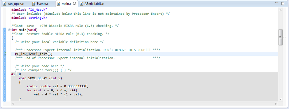

I checked the project of uart-test-isr, and tried it on the FRDM-KL05Z, what I did is just changing the MCU device as well as the GPIO component and comment out all the main code except PE_low_level_init().
It works well as expected. The interrupt service hits when I input some character to UART0, so the configuration should be right.

But still, I checked it now with only PE_low_level_init() left in main(), with a simple loop toggling TX_REQ pin with a delay. The result is the same - the interrupt does not occur (I'm adding a breakpoint in the same line, as you are; debugging generally works as expected - stops on breakpoints in the main loop and so on).
