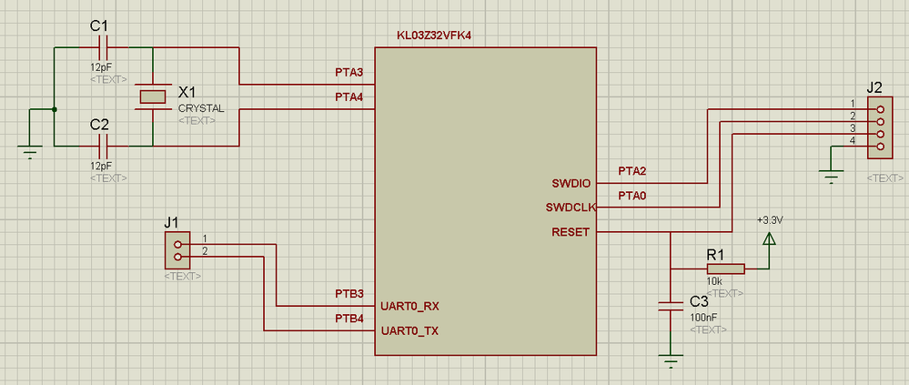

hello
Function:J1  TX/RX communication  about out;
                  J2  Debug and download
i will use develop tool with keill .
question:
1.Can the schematic function be realized?
2.KL03 debug and download ,need other tool?can you recommend?
3.if not ,shoud you send me a schematic system
1,378 Views
Hui_Ma
1> The KL03 Min. system should provide VDD and VSS to KL03 chip;
2> The debugger tool, customer could select Segger J-Link or P&E USB Multilink tool;
3> We have the FRDM-KL03 board for customer to refer.
Thank you for the attention.
