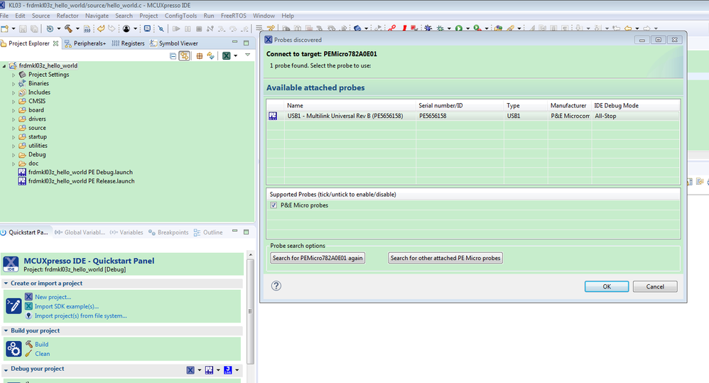

Have a custom board with KL03Z32VFG4, code is a very simple hello world app. Trying to debug/Flash using a P & E micro MultiLink ACP. MCUExpresso is version 10.2. Have performed the latest Eclipse updates and also installed the latest P&E micro drivers. The Multilink ACP  is detected, however when I initiate debug/Flash,  the IDE hangs and the progress bar shows 99% and details say Launching: Configuring GDB. The Only way to exit this situation is to kill the pegdbserver_console_(32bit) from Task manager or hit the Cleanup debug button on the task bar. Has someone encountered this issue if so what is the solution to this?

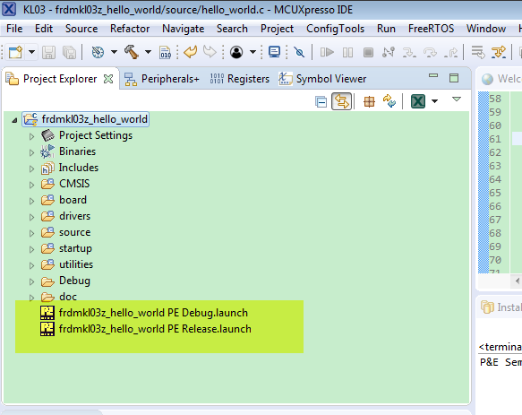

     1) clean the project
     2) delete the following file, then build and download it again:

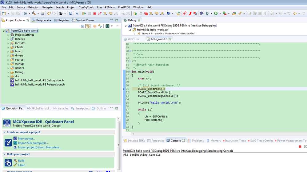

The following is my multlink universal download information
You must make sure your multilink SWD interface is connect correctly to the customer's KL03 board.
Wish it helps you.
