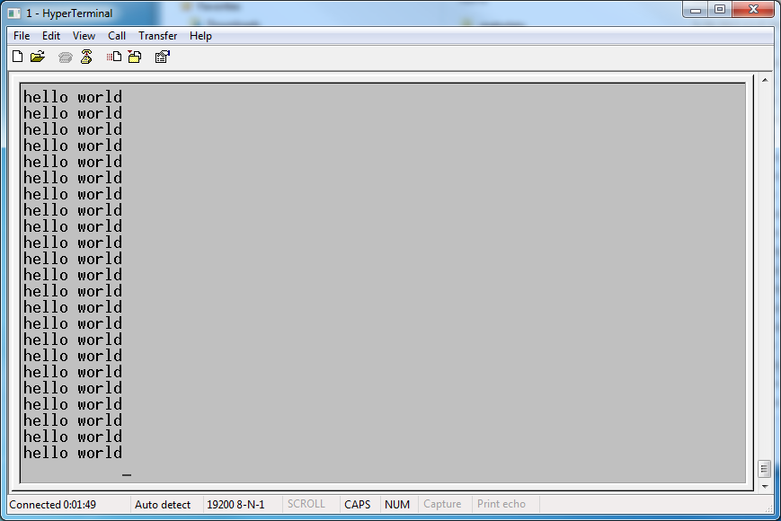

Hui_Ma
I also create an example based on FRDM-KL03Z with LPUART0 output "hello world" to on board OpenSDA virtual serial port. There doesn't appear garbage data, please check below picture for my test result:
I attached my test project for your reference.
Wish it helps.

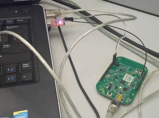

Hui_Ma
I am using a CP210x USB to UART Bridge board to get LPUART0 transmit data.
I still could get the correct data at serial terminal.
Below is my test environment:
I would recommend to check the serial to USB converter tool, if there with another one could try with it.

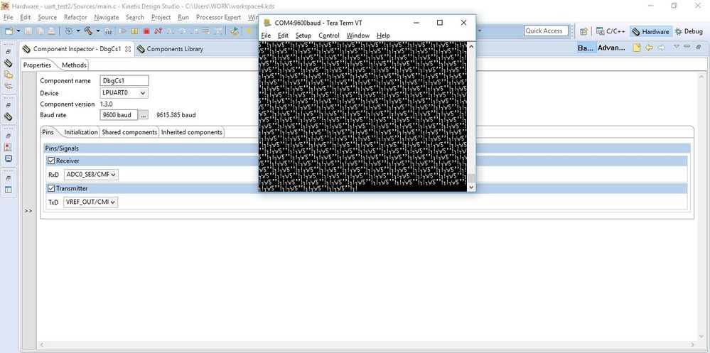

armaram
I tried with two different USB to serial converters.
Following is the screen shot for the program you shared. I think it is got to do something with the clk settings, but unable to nail down the exact parameters to tune.

Hui_Ma
For the KL03 IRC is factory trimmed with ±3% accuracy, which clock accuracy matches with UART spec requirement.
Have you checked the LPUART TX signal quality with scope? Is that signal robust?
And it also need to check serial terminal software. Could you try another PC serial terminal software?
