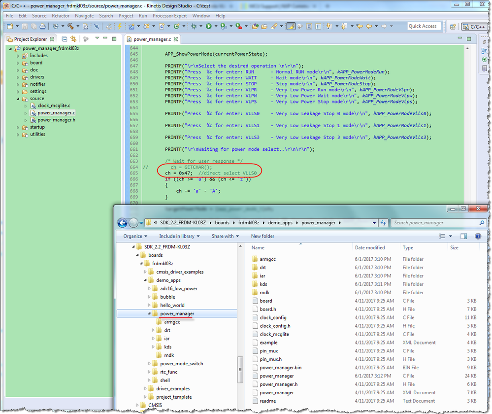

I try to test power_manager demo in SDK_2.2_FRDM-KL03Z with FRDM-KL03Z, the code can run into VLLS0 when the VDD voltage drops below 2V. You can modify the code as shown below to test it on your custom board. I also attached the test project here.
Please attach a simple test project here, so that I can direct test it.

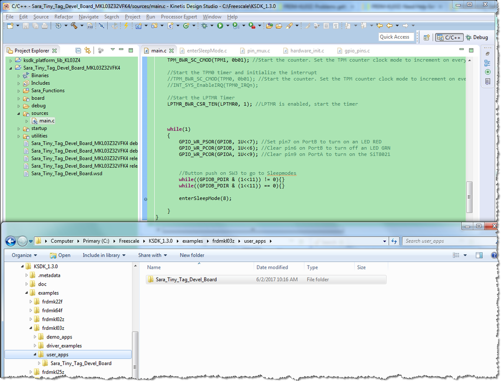

I am well aware of the information in the document: 'FRDM-KL03: Getting into VLLSx Modes and Waking from them<https://community.nxp.com/thread/450591> since I wrote it! I am most certainly taking care of the errata as described,
Attached is a zip file of my project. I wonder if it is related to the fact that I’m using KDSK based on the FRDM-KL03 when I don’t actually have the evaluation board…I have my own development board.

Put your project into SDK folder.(C:\Freescale\KSDK_1.3.0\examples\frdmkl03z\user_apps)

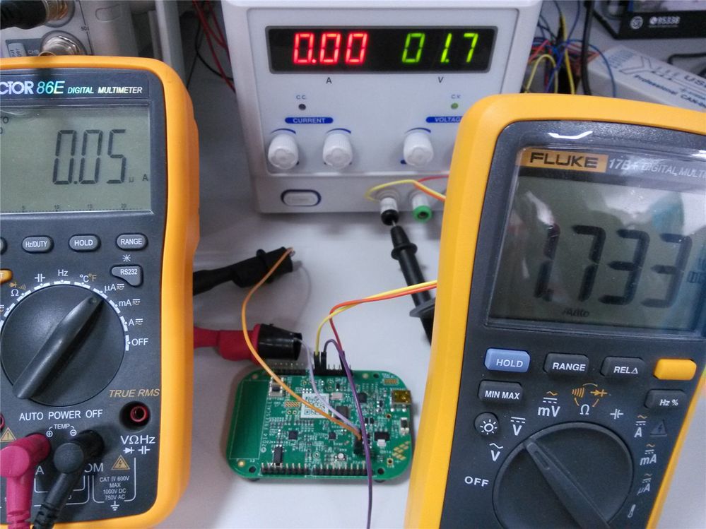

My FRDM-KL03Z board(SCH REV B2) can run into VLLS0 after I connect the GND to PTB11 through a wire.(I'm not sure if your FRDM-KL03Z can do this either)
You can see that the VDD is 1.733V and the current will down to 0.05μA.(It meet the data IDD_VLLS0 in datasheet which is about 77nA.)

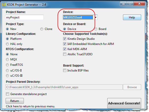

Since you are testing the custom board, have you try to generate the project and select specific Device?

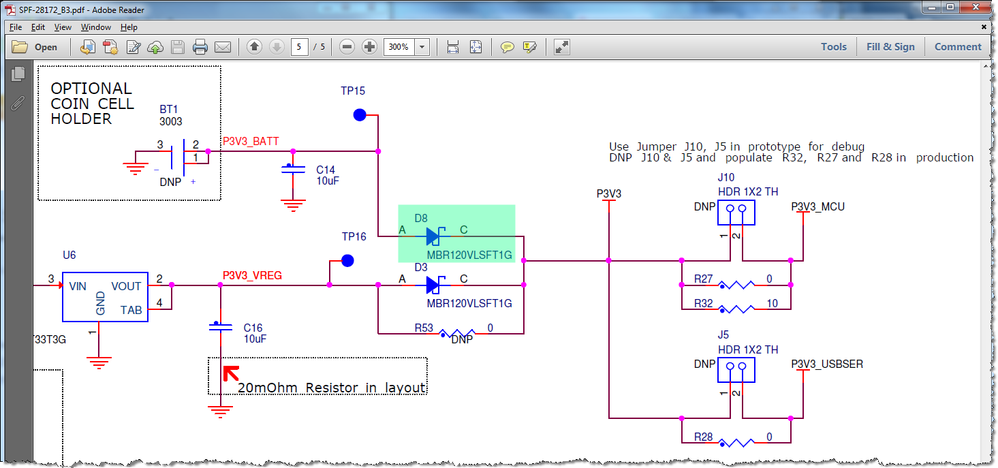

Would you please tell us how did you power the FRDM-KL03Z board?
If battery is used to power it, have you take the voltage drop of D8 into accout?
P3V3_MCU drops slightly below 2V or P3V3_BATT drops slightly below 2V?
If you are test it with FRDM-KL03Z board, please attached the project here so that I can test it.
