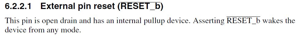

Page 9 of Rev4 of Document KL02P20M48SF0 states:
2. The reset pin only contains an active pull down device when configured as the RESET signal or as a GPIO. When
configured as a GPIO output, it acts as a pseudo open drain output.
My question is:
Why does this state that the reset pin contains an active pull down device?  The reset for this chip is active low, so shouldn't the chip contain a pullup resistor?
Or, am I reading this incorrectly and there is both a pullup resistor and an optional pulldown device?
Thanks!

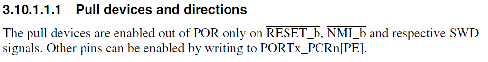

The text does look to be confusing or possibly not quite right.
If you check the user's manual it should however be clear that the RESET_b pin has a pull-up when configured as reset. See several sections, which all reinforce this:
Table 6.1
Mark

hughesk
Thank you, this clarifies things.  At the very least, that's 3 pullup references to 1 pulldown.  I'll also check this in-circuit.
