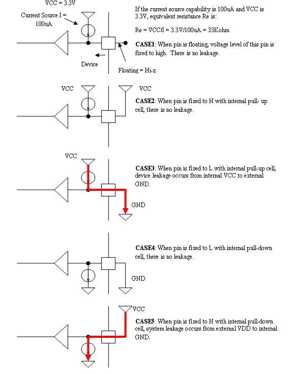

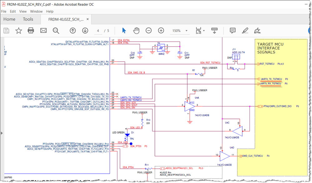

External circuit connect to KL02Z chip may cause the extra current.
See Optimizing IO Power Consumption.

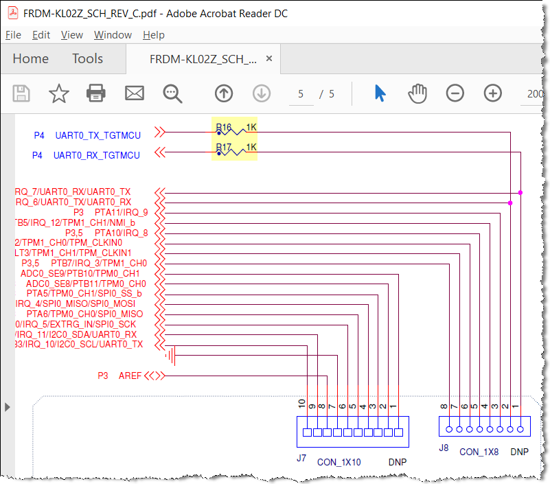

For the FRDM-KL02Z board, please try to remove the R16 first.(You can modify the codes in frdmkl02z_power_manager, select VLPS mode by codes instead of through UART)

If you don't want to modify the hardware, then before enter VLPS mode: you should reconfigure the UART pins to GPIO function, then configure the GPIO output voltage equal to external circuit.
