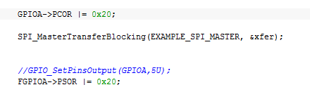

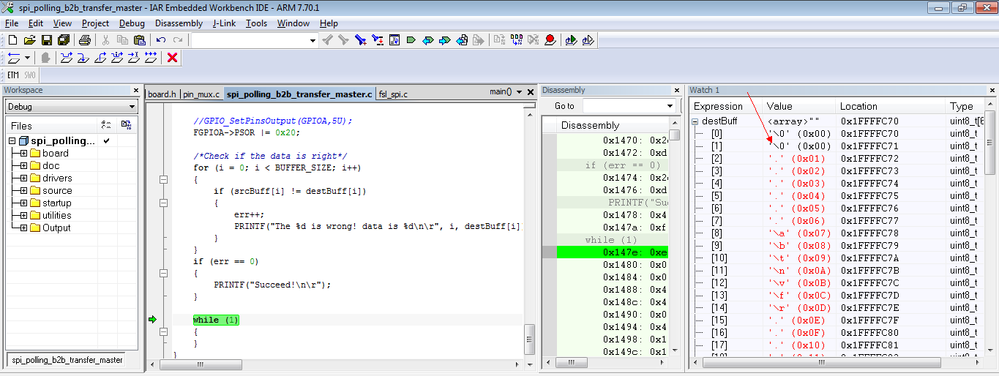

Just as normal SPI usage, after the basic configure, I pull low the CS pin before the data transmit, pull high after it finished. But I don't know why the destBuff would get an extra "0x00", then it made all data in wrong order.

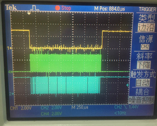

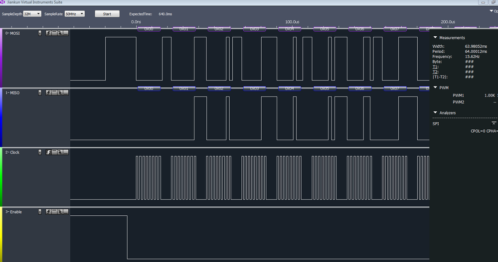

we checked the waveform, didn't find any issues.
(pic is not clear, yellow line is CS, green line is clock, blue line is data.)

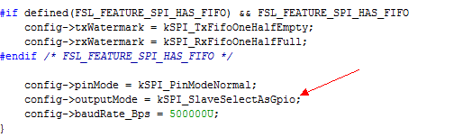

I use the blocking transfer directly, add GPIO operation.
configure spi SS function.

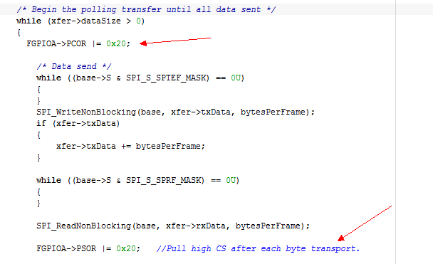

But if I simulate GPIO as the auto-ss function, pull high every time after byte transmission, it could work.
Pull high CS every time.

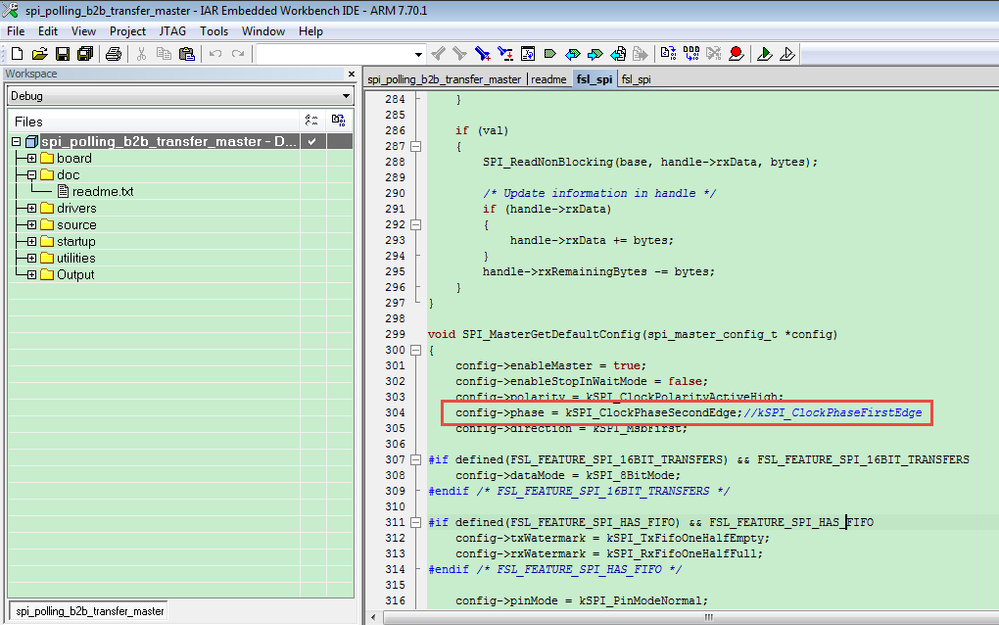

     Please modify the master and the slave CPHA to 1, then the problem will be solved.
   1. Modify the master clock phase to 1.
2. Modify the slave clock phase to 1
3. Test it.
The SPI wave is:

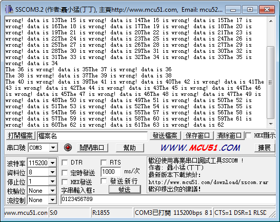

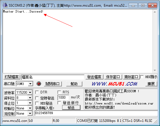

The Master printf data is:

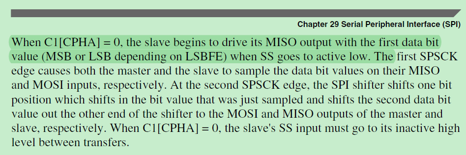

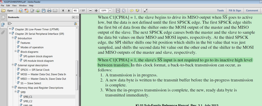

About the reason, you can find it from the KL02 reference manual:
So, when use the GPIO as the CS, please use the default CPHA=1.
