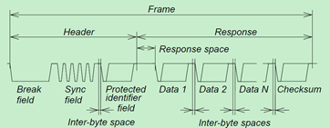

    The following figure is the structure of a LIN frame:
Figure 2-2. LIN frame structure
     LIN frame is constructed of one Break field, sync byte field (0X55), PID, data and checksum.

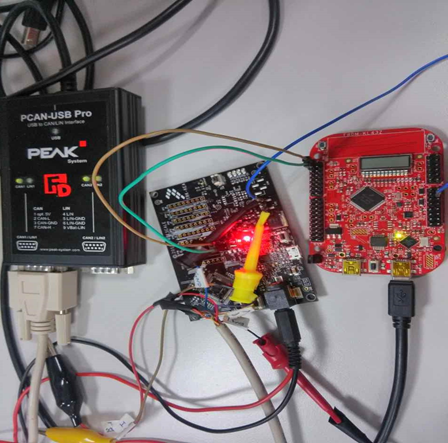

3.1.3 Object connection picture
Figure 3-2. Object connections

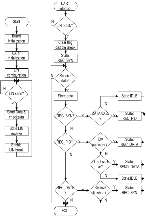

3.2 Software flow chart and code
     Now describe how to realize the LIN master and the LIN slave data transfer. LIN master send a publisher frame, the slave will receive the according data. LIN master send a subscriber frame, the slave will send the data to the master. The code is based on the KSDK2.2_FRDM-KL43 lpuart, add the LIN operation code.
 3.2.1 Software flow chart
Figure 3-3. Software flow chart

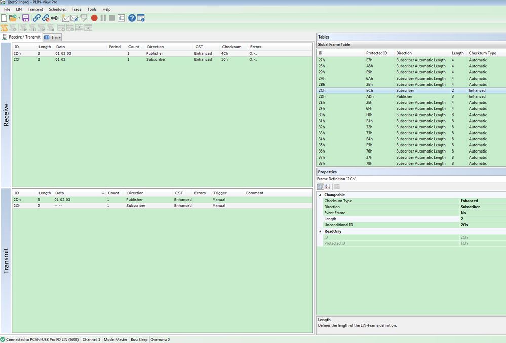

4 KL43 LIN slave test result
  Master defines two frames:
Unconditional ID
Protected ID
Direction
Data
checksum
0X2C
0XEC
subscriber
0x01,0x02
0x10
0X2D
0XAD
Publisher
0x01,0x02,0x03
0x4c
   Now, master send 0X2C and 0X2D data, give the test result and the according waveform.

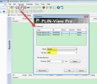

4.1 LIN master configuration
Uart baud rate is: 9600bps
4.2  Send ID 0X2C and 0X2D frame

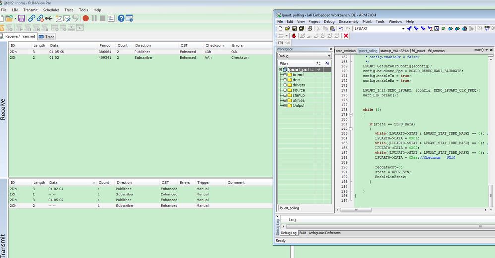

    From the PC software of LIN master, we can find 0X2D ID can send the data successfully, and 0X2C ID can receive the correct data (0x01, 0x02) and checksum (0x10) from the KL43 LIN slave side.

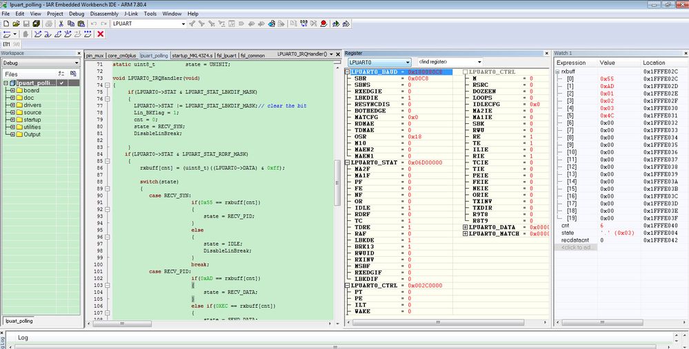

4.2.1 0X2D ID frame oscilloscope waveform and debug result
   From the debug result, we can find the buff can receive the correct ID, data and checksum from the LIN master.

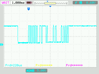

 4.2.2 0X2C ID frame oscilloscope waveform

  From the PC software, we can find if the KL43 code modify the checksum to the wrong data 0XAA, then the PC software will display the checksum error.
This is the according oscilloscope waveform for the wrong checksum data.
