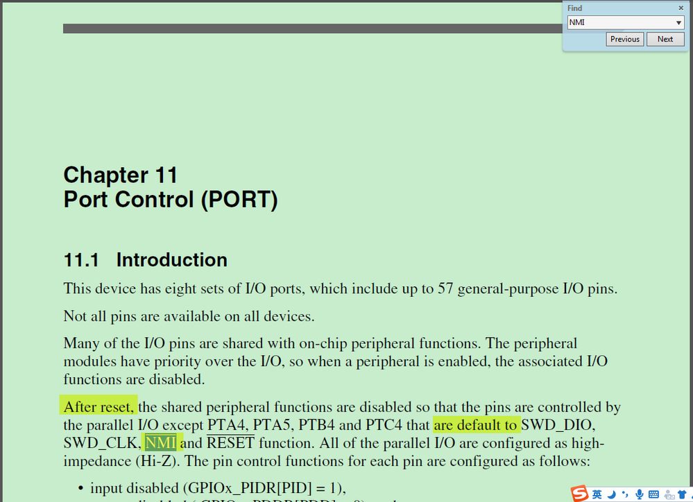

Hi!
As said in the title I have a problem with the !NMI pin at startup. It is used for SPI_MISO communication.
It's causing problems when I turn on the power supply. The IC that it's communicating with apparently holds down the pin and the NMI gets asserted at startup which causes the uC to lockup (reset won't help).
I tried with a pullup resistor but it seems to deassert it to late.
Does anybody know a way around this problem? Can I disable the NMI pin permanently (I couldn't find anything in the datasheet) ?

Hi Customer,
    It is not the problem, it can be said just the KEAZN16 feature, not only the KEA have this feature, KE series also have this feature.
    NMI pin can't be disabled permanently!
     From the reference manual, you also can find this feature:
Actually, even you disable the function in SIM_SOPT[NMIE], but take care, this is just use the code to disable it.
But after reset, the PTB4 already be NMI function in default.
So, if you want to use the NMI pin as the other function. You must make sure during the reset, you should keep the NMI pin to high in the outside circuit.
Actually, I also don't recommend the customer to use the SWD and NMI pin to other functions, just for this reason.
Wish it helps you!

     KEA series is special, the NMI pin will still be the NMI function when you power on the chip even you already disable it, so, it's better to keep the NMI pin high during power on.
Kerry

My problem was near the same. We have an accelerometer connected to NMI pin via SPI. At startup its power supply was turned off and the IC pulled down the NMI pin.
To solve this I added the NMI interrupt handler and enabled the power supply there:
void NMI_Handler(void)
supply_on();
When the accelerometer get power supply it set its pin to HighZ and released the NMI pin.
I hope it helps!

    Actually, just one point, if the NMI pin is low, it will enter NMI handler  during power on, even you disable it.
   This is the KE, KEA series feature need to take care, K, KL series don't have this feature.
