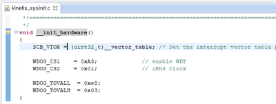

Hi NXP
The Watchdog is working well when after MCU Reset
but when trying to reconfiguration on main code
we can't enable the watch dog
do you have any idea about that problem? thank you

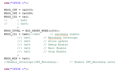

lim
Watchdog Configuration when after MCU reset
it's working
when trying to enable the watchdog on main code
it doesn't working
You can refer the WDOG example in FRDM-KEAZ Freedom Evaluation Board – QSP(...\FRDM-KEA-QSP\Quick Start Package v8\Code Project Examples and Sample Drivers (Evaluation Grade Only)\FRDM-KEAZ128\Driver Test SW for KEAZ128\Driver Test SW for KEAZ128\FRDM_KEA128_WDOG)
