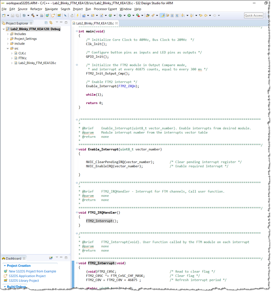

I'm trying to create a single-shot timer using the flex-timer module and overflow interrupt. Does anyone know if there is an example somewhere that demonstrates this?

Please refer the Lab2_Blinky_FTM_KEA128 in FRDM-KEA Quick start package(REV 8).
(C:\Quick Start Package v8\Code Project Examples and Sample Drivers (Evaluation Grade Only)\FRDM-KEAZ128\Code Project Examples for FRDM-KEAZ128\Code Project Examples for FRDM-KEAZ128\Lab2_Blinky_FTM_KEA128)
But you may need to stop the counter in FTM interrupt.

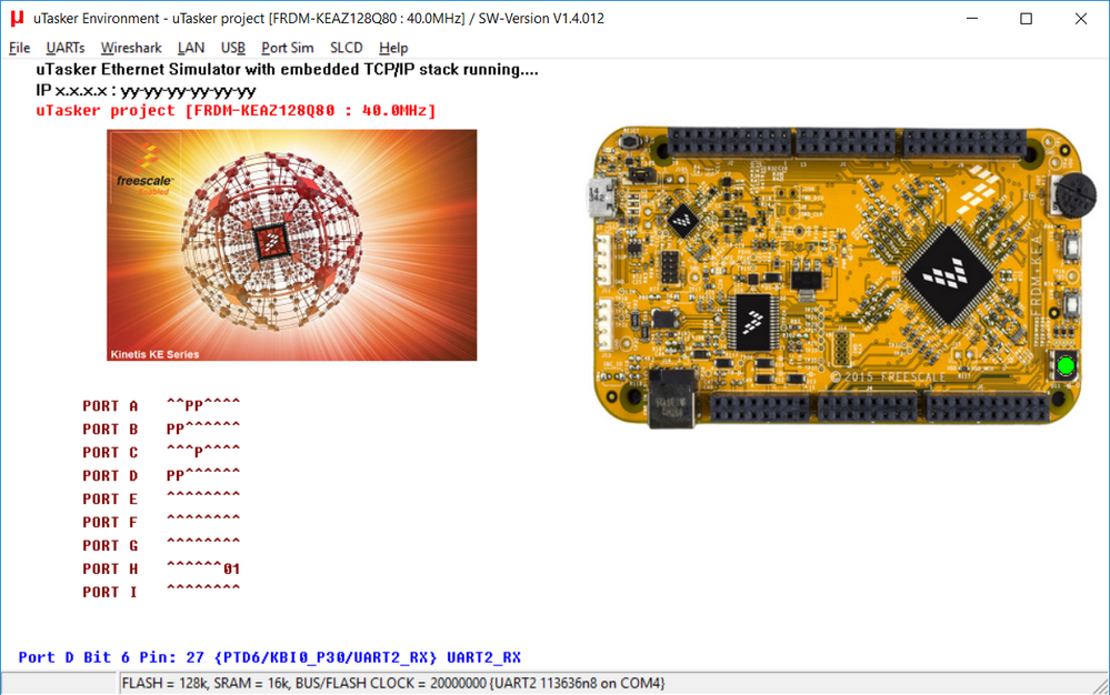

You can find FlexTimer and PIT single-shot references in the Open Source uTasker project for KEA128 (including timer simulation in Visual Studio).
http://www.utasker.com/docs/uTasker/uTaskerHWTimers.PDF
Attached are two binaries for FRDM and TRK board that show a single shot timer interrupt (FlexTimer) toggling an LED (red on FRDM, second blue one on TRK). Each time it fires it increases the time by 100us and repeats so that the toggling gets slower the longer it runs for.
There is a command line interface on the OpenSDA VCOM at 115200 Baud - in the I/O menu there are commands to read memory so you can view the timer setup if required.
Mark
