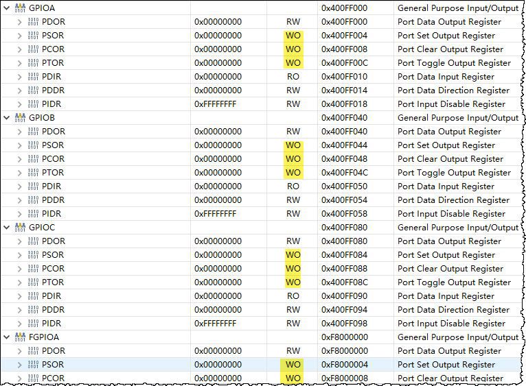

 I want to  watch the regisiter of GPIO  in  nxp  S32DS  for arm2.2(windows ) software, but in debug mode the regisiter of GPIO do not change , Please show me, how to wath the regisiter in s32ds , thanks.
  I use KEA128(S9KEAZ128AMLH) mcu  and USB-ML-UNIVERSAL .
The  code and the  picture of regisiter  as follow:

Hi  chumcu,
Some of the peripheral register are WO(Write Only), so you can not read back to check if it was changed.

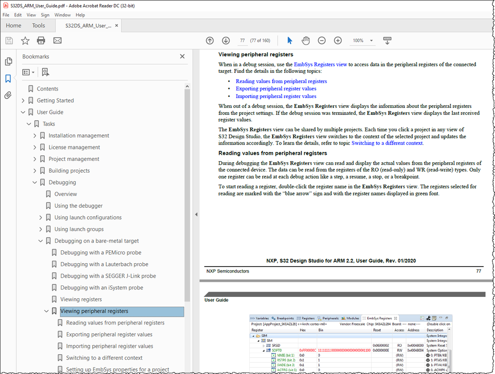

Please refer to C:\NXP\S32DS_ARM_v2.2\S32DS\help\pdf\S32DS_ARM_User_Guide.pdf
