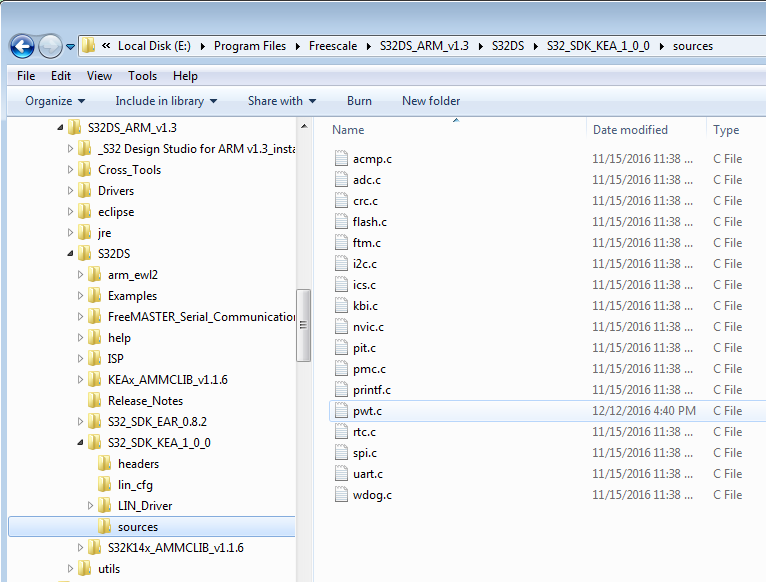

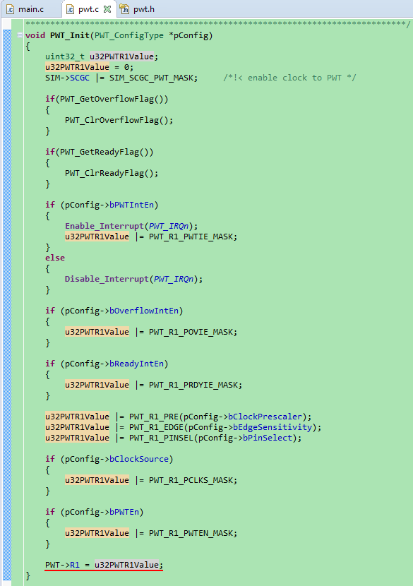

To avoid unexpected behavior, do not change any PWT configurations as long as PWTEN is set. I saw that you enabled that bit at the beginning of PWT_Init().
I think you can refer the PWT_Init() in pwt.c.
The pwt.c can be found in below folder. For example: ...:\Program Files\Freescale\S32DS_ARM_v1.3\S32DS\S32_SDK_KEA_1_0_0\sources
The S32 Design Studio for ARM v1.3 IDE can be download from here.

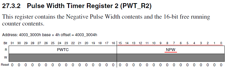

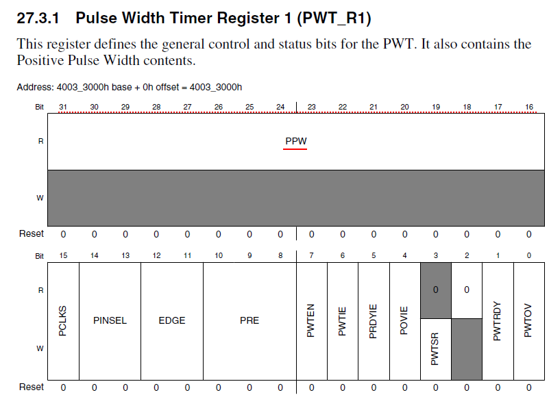

Please see the Register of PWT_R1 and PWT_R2 first.
The PositivePulse = (PWT_R1 & PWT_R1_PPW_MASK)>> PWT_R1_PPW_SHIFT; due to it's located at the higher 16bits.
The NegativePulse = (PWT_R2 & PWT_R2_NPW_MASK) ; due to it's located at the lower 16bits.
Robin
2,482 Views
