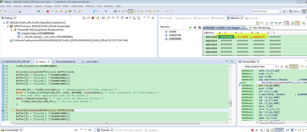

Dear Boss,
I am using S9KEA128AMLK, and I find some problem when using its flash.
I used process expert in CW 10.7 to generate the code like this:
Err = IFsh1_SetByteFlash(0xE000,23);
And the returned Err value is always 0x03.
The data stored in 0xE000 is 0xFF.
When I tried to use Local Device Driver, I find that no matter what address I put in the box, an error "already used by CPU" is reported.
Please help about this problem, see also the attached figures for details.
Thank you very much.

Hi xiaopeng,
   From your description, it seems your flash address 0xe000 is used by the code.
   You can check your code size, whether it is exceed the 0xe000 or not?
   I suggest you use the last flash sector as the flash module operation area, you can try it at first.
   If you still have question about it, please kindly let me know!
If you still have question after the test, please tell me the updated information.
Wish it helps you!
Kerry

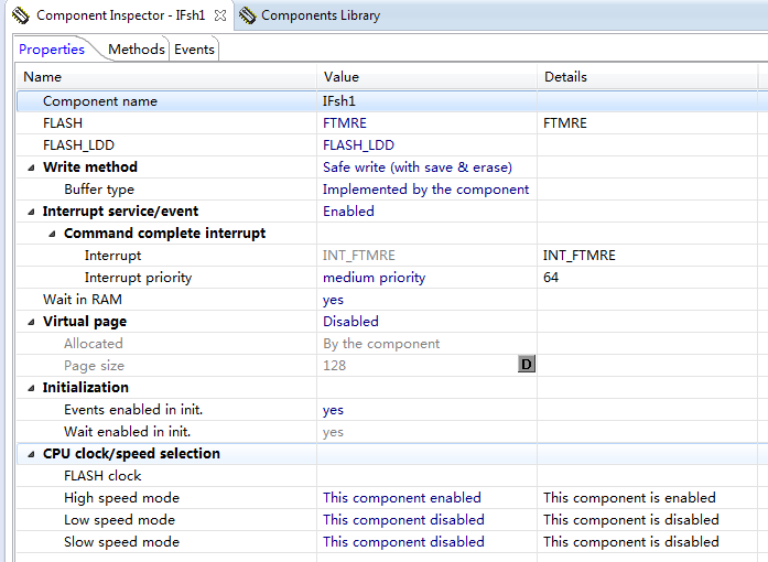

Dear Kerry,
Sorry, I have tried different addresses, but it is still not working.
I am not sure about how to see the code size, so I provided the code generated by CW when building the project.
I also screen capture some of the PE configurations of my project for your reference.
Thank you very much and hope to hear from you soon.
Xiaopeng

Flash Configuration
Flash LDD configuration

xiaopengtang
Thank you and your provided project works finally.
But I still have some problems:
1. I have to use my jlink to unlock the device, and your code can work then;
2. I still want to know whether it can work on IntFLASH component.
3. How to see which part of the flash can be used by the users for S9KEA128? The reference manual is not very clear.
I still cannot use this IntFLASH component for "destructive write".
It jumps to the system unhandled interrupt when I tried "Erase Sector".
I used the same address, 0x16000, but I got a result showing that "No source available for "0xFFFFFFFE (0xFFFFFFFE)() " "
Xiaopeng

kerryzhou
Hi Xiaopeng,\
  Please check this code again on your side. I add the erase flash at first. Please test it again.
   Actually, the code which I give you is using the internal IRC, so, it should also works on your side.
   Please debug your code, check memory like the picture which I give you in the above reply.
  Check flash address 0x00016000 data after write the flash.
Wish it helps you!
