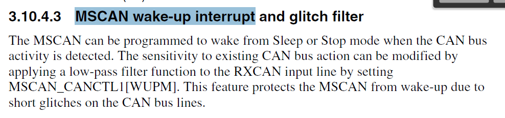

      I now use kea128+TJA1044,I want to realize the Remote wake up.but I donot know how to do it.
when initialize I set the kea128 CANwakeupen,I pull down the standby pin of TJA1044.
when enterstop, I pull up the standby pin of TJA1044.but it cannot wakeup by canbus.
1 返信
1,459件の閲覧回数
kerryzhou
Hi customer,

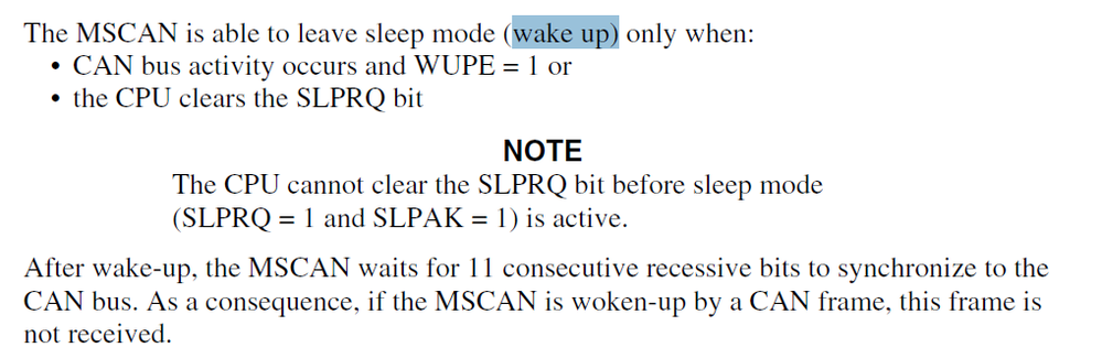

    KEA128 MSCAN have the wake-up interrupt to wake from sleep and stop mode, you can find details from the reference manual:
and chapter: 32.4.6.5 MSCAN sleep mode
Wish it helps you!
