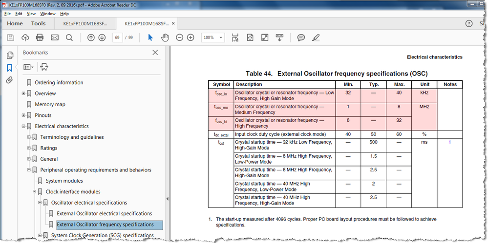

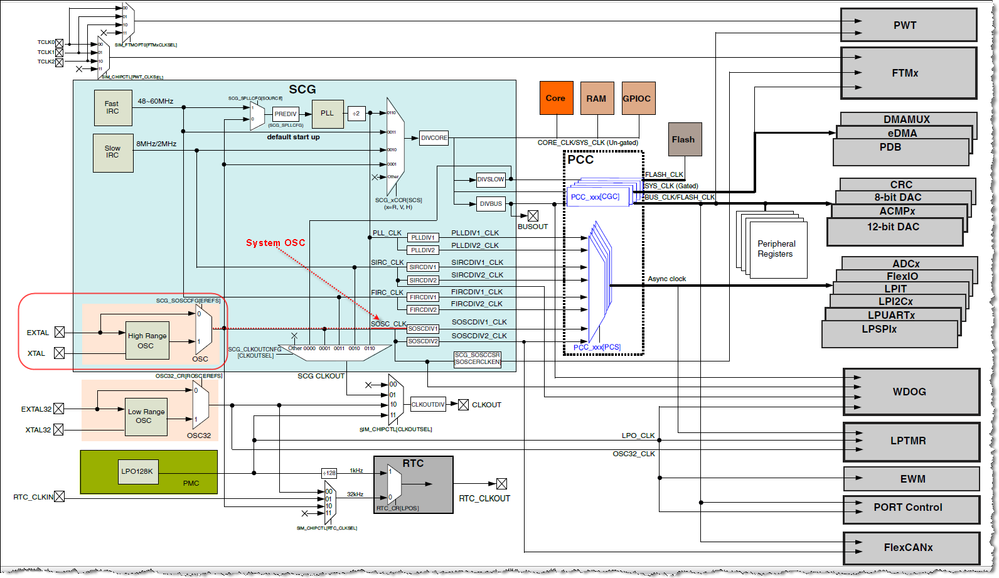

Robin_Shen
Hi David,
Sorry for the late reply!
System OSC can be configured as clock source to tune the Fast IRC.
And you can find the frequency in  'Table 44. External Oscillator frequency specifications (OSC)' of KE1xFP100M168SF0.
Robin
2,468 Views
davidsherman
Senior Contributor I
Unfortunately, that didn't answer my question at all.  I've already seen exactly what you've posted, there is no mention of the reference frequency the auto tune needs.  It talks about the divider "divide the system OSC down for Fast IRC trimming", but what frequency do you divide it down to?  The frequency ranges you mention only show the ranges the oscillator is capable of working, not what the reference frequency for fast IRC trimming is.
