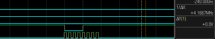

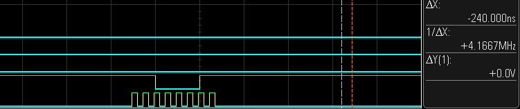

I'm trying to figure out how SPI Slave (FRDM-KE02Z) works. Two boards are connected only by GND and CLK  (Slave is FRDM-KE02Z and Master is MCU board(not Freescale)) .
Master sent only CLK to Slave. Slave is configured: Clock polarity: Low, Clock phase: Change on leading edge. Immediately after power-up, Slave work correctly, it sends out data accurately by master clock, bit by bit on clock period. But when I reset Master board, data is shifted relative to clock, as on on figures below. Could somebody enplane me , how to get rid of shifting
Normal
Shifted

I think this happens because while the clock signal shifts the data in the shift register, I do reset the clock signal, but the data not shifted until end, and when clock signal comes again to shift register, it begin shifts the data from last point. How i can clean shift register in such case?

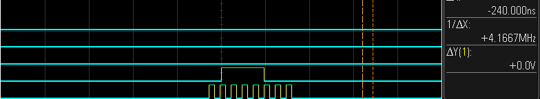

I can't try power off/on because the central idea of my project is frequent  sensor checking. There is a sensor which has an interface similar to the shift register:clock input pin, data output pin. but it's not that simple, it has CS pin. My idea was use KE02Z between some Master device and the sensor, because Master device doesn't has CS signal,  KE02Z SPI must determine there is clock signal from Master device to sensor or not, and if it there is, send CS signal to the sensor by MISO. I connected clock signal output from Master device to sensor and KE02Z clock input. CS pin of sensor to KE02Z MISO, and when Master device send 18 clock periods I'd like that KE02Z starts MISO transmission to sensor CS pin on first clock period and ends on last clock period.
Sorry for complex description.:smileysilly:
It may be better to solve this problem on timers, timer counts 18 clock periods and send CS signal via GPIO. How to do that it would work as quickly as possible?? Clock frequence is 4Mhz
