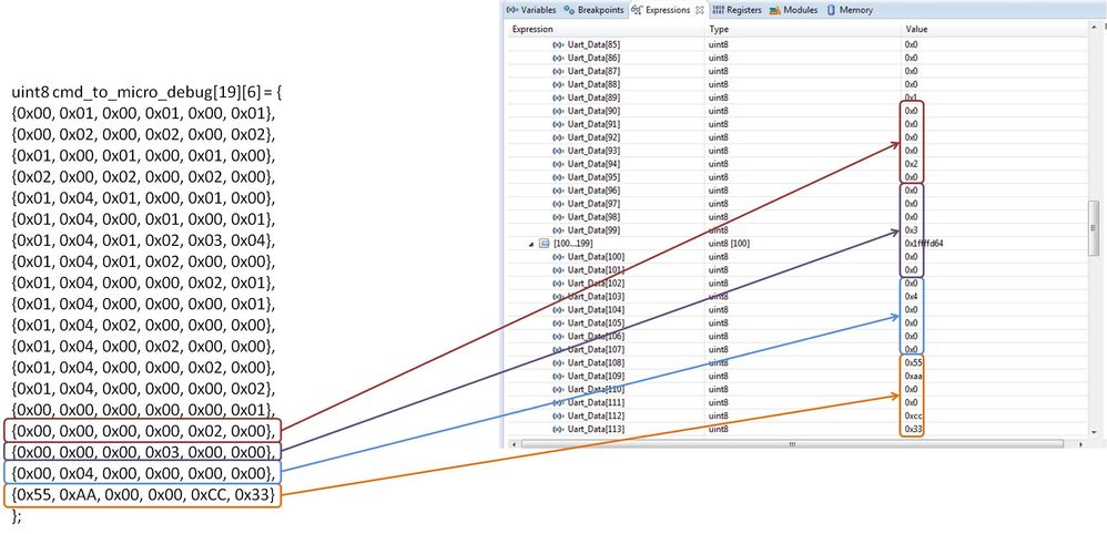

isaacavila
Hello Umsankar
I tried to test your code on FRDM-KE02Z and FRDM-KL02Z to communicate each other. I just connected RX and TX (cross connection) on both boards
(PTB1 (UART0_TX) of FRDM-KL02Z to PTC6 (UART1_RX) of FRDM-KE02Z,
PTB2 (UART0_RX) of FRDM-KL02Z to PTC7 (UART1_TX) of FRDM-KE02Z
and connect GND signal, just as shows next image).
And I had no problems on transmitting and receiving the same bytes (As you can see, i added another row of data and it was received correctly).
Uart_Data[].jpgThis makes me think there is a hardware issue in your custom board.
As UART’s clock is taken from internal references, could you please validate voltage level and verify ground potential is the same for both MCUs?
If issue persists, it would be useful to give more information about your hardware.

umsankarkalluru
Hi Isaac Avila,
Thanks for spending time and providing the feedback on this.
The above experiment you did and code I have provided works communicating from KE02 to KL02, but the actual problem was to communicate from KL02 to KE02.
I repeated the experiment with custom board with KL02 processor and FRDM-KE02Z board and i still face the issue of not communicating properly from KL02 to KE02.
Please find the attached code which will communicate from KL02 to KE02,
Since I don't have KL02 freescale demo board , can you please run the attached firmware on the above setup you have and let me know if you see the correct bytes.
Thanks again for your help.
