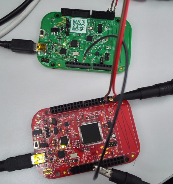

Hui_Ma
I do a similar test with FRDM-KE02Z board and FRDM-KL02Z board.
I don't meet you mentioned issue.
You could find my test video and I also attached the test code for your reference.
(view in My Videos)
Wish it helps.
Ma Hui

Hui_Ma
I find similar error with FRDM-KL02Z board.
When using the same routine with FRDM-KE02Z, there will added to send a 0x00 and the following data is also incorrect.
So, I change the transfer way and using below code, I will get the correct data output from FRDM-KL02Z.
Error = AS1_SendBlock(MySerialPtr, OutData, 8U);/* Initialization of AS1 component */
Please try if it works for you.
Ma Hui
