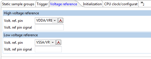

I am trying to read four channels of ADC using KDS on TRK-KEA64 and I read all zeros including the light sensor channel.  I have used the same KDS project on TRK-KEA128 to do the same thing and it worked fine.  Then I switched to TRK-KEA64 and selected the processor SKEAZN64MLH2, All four channels read zeros.  Do I have to configure clock and ADC differently from TRK-KEA128 in addition to choosing different processors?

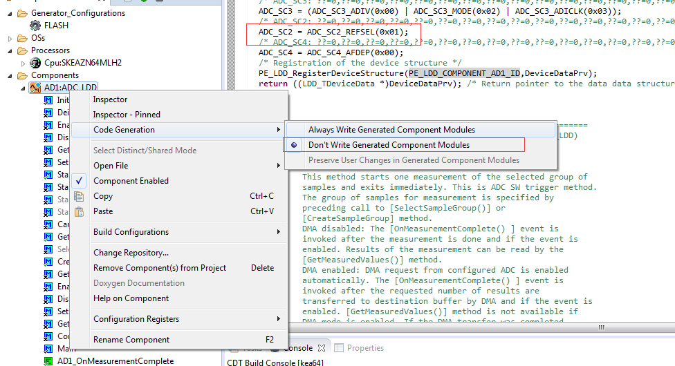

In the code ADC0.c file if I change the ADC_SC2 = ADC_SC2_REFSEL(0x00) to ADC_SC2 = ADC_SC2_REFSEL(0x01) I can get some ADC readings.  However if you generate code, you erase this change.  So the question is in the KDS how do I configure the ADC reference voltages?  I configured as below but in the code the line ADC_SC2 = ADC_SC2_REFSEL(0x00) set to default.

Hello david,
I have test on my side ,it is the same wiht you , ,maybe there are some problem here.
And you can do like this : change the ADC_SC2 = ADC_SC2_REFSEL(0x00) to ADC_SC2 = ADC_SC2_REFSEL(0x01) ;
    then right click the ADC component , select "Don't write genereated component modules" .
