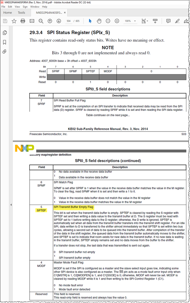

Hi michaeltoaldo,
According to the SPI Status Register (SPIx_S), there is no such flag for "OnTxChar", seems that only "OnFreeTxBuf" available.
I didn't find that automatic toggle is not allowed in CPOL = 1 CPHA = 1 mode, have you tried it?
