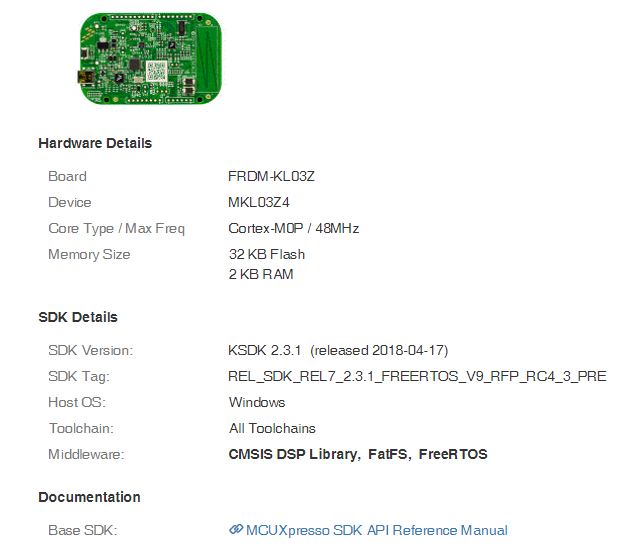

Currently, the MCUXpresso SDK for FRDM-KL03Z software version is V2.3.1.
The KL03 SDK software provides interrupt and polling modes I2C slave driver and demo project.
Please download the latest SDK software from here and check if there with the same issue.
