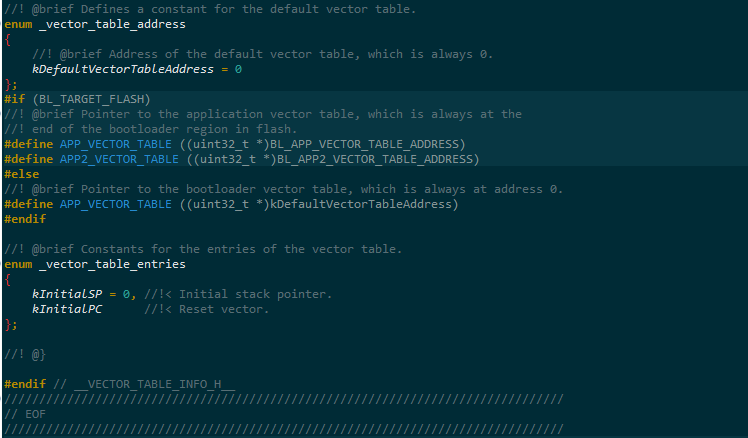

Currently,
vector_table_info.h:
//! @brief Pointer to the bootloader vector table, which is always at address 0.
APP_VECTOR_TABLE = ((uint32_t *)kDefaultVectorTableAddress)
This works for the default app location of 0xA000.

I have a feeling APP_VECTOR_TABLE needs to reflect my application's vector table.

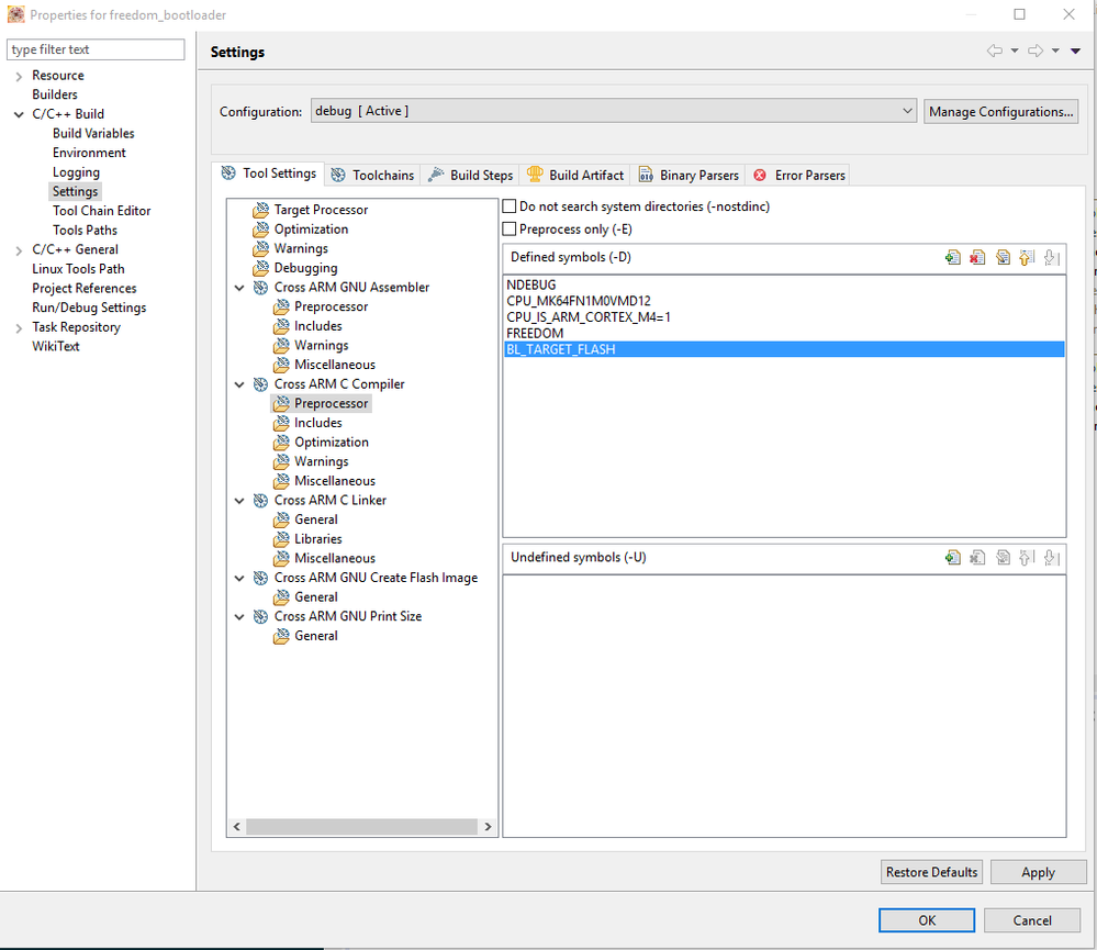

Also, BL_TARGET_FLASH is defined in the preprocessor but I don't see the #if statements responding correctly.

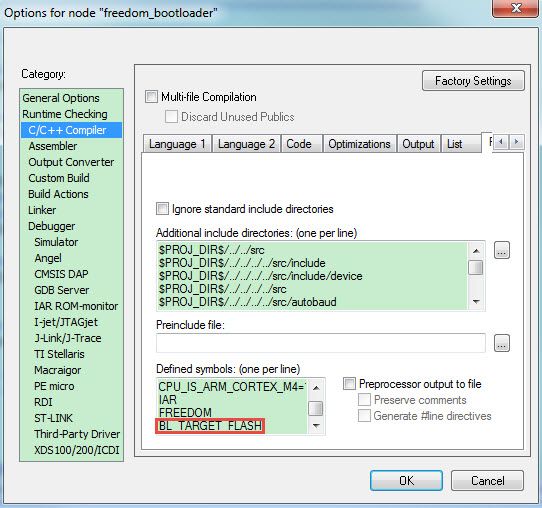

First of all, you can find the BL_TARGET_FLASH is defined as the Fig 1 shows.

That's about what I have but with some names changed.
For some reason, BL_TARGET_FLASH is still not taking in KDS 3.0.0
Note below APP_VECTOR_TABLE and APP2_VECTOR_TABLE are grayed out.

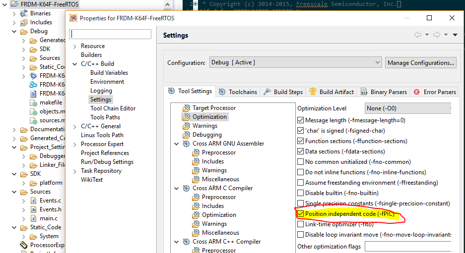

Because I wanted to place the code in either slot, I had to make it Position independent.
Project -> Properties -> C/C++ Build -> Settings -> Tool Settings -> Optimization -> Position independent code.
Now since the binary was position independent, I had to add my offset to the bootloader.
PIC appEntry   + sector offset  = actual appEntry
0x0000_A4C9 + 0x0002_0000 = 0x0002_A4C9
